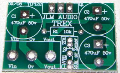

TREX is replacing the original simple zener regulator kit. The same regulator circuit can be built on the TREX PCB with the added features better smoothing and soft start and the option of using a zener diode or when run from a regulated rail like our 48v SMPS a 20k 25 turn trim pot can be used instead of the zener to give a adjustable voltage from 1.5v to 30v.

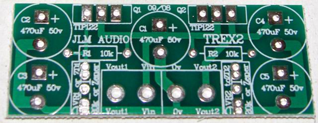

TREX2 is a dual version of the TREX with 2 adjustable voltage rails.

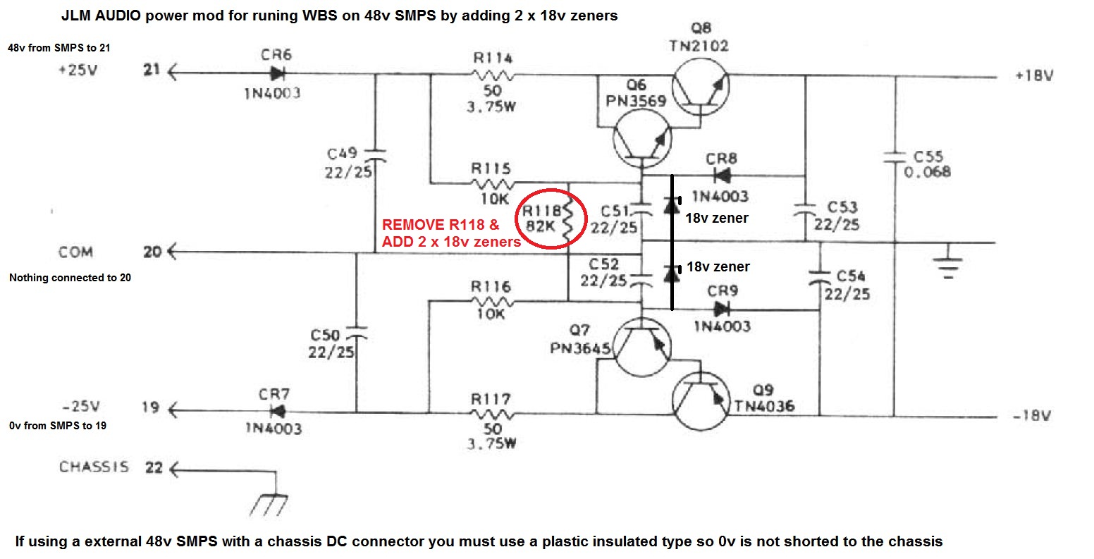

Short one: If i need a +25V and -25V can i modify the TREX to get this values (probably with another TIPxxx transistor). I need those +/-25V for WBS rack ...
Thanks for any hints/infos.
Re: TREX and TREX2 Transistor regulator kit
janczmok wrote:Short one: If i need a +25V and -25V can i modify the TREX to get this values (probably with another TIPxxx transistor). I need those +/-25V for WBS rack ...
You can build a negative TREX or TREX2 by reversing all the caps and zener if fitted and use a PNP TIP126 instead of the NPN TIP122. But you cannot get a + and - rail at the same time out of the TREX2.
Most WBS gear wastes the +/-25v down to 2 x 18v zeners in the module to make +/-18v so can be easily powered by a 48v SMPS and nothing else. Or you can use our AC/DC kit with power transformer.
Send me the circuit for the WBS device you want to power by email and I can show you how to power it.
Most small WBS modules have a simpler resistor and 2 x 18v power supply and need no modifying but the larger modules with the extra transistor stage need R118 removed and 2 x 18v zeners fitted to work direct of the 48v SMPS.

Thanks for the info. I've implemented it and now got a fully blown two channel racking :-) It's working perfectly, thanks for the good tip + advice. NO noise or hum at all.
janczmok wrote:Thanks for the info. I've implemented it and now got a fully blown two channel racking :-) It's working perfectly, thanks for the good tip + advice. NO noise or hum at all.
Cool good to hear you got it to work :-) yes it makes powering WBS modules very easy and with minimal cost and no hum or noise problems.
