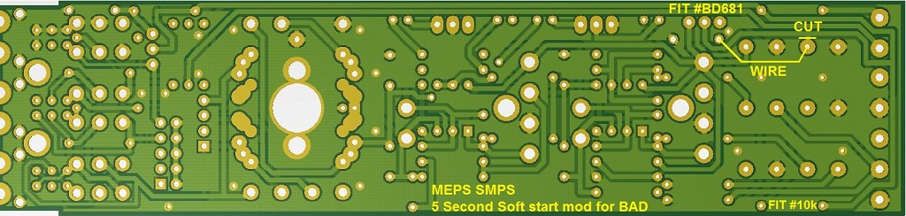

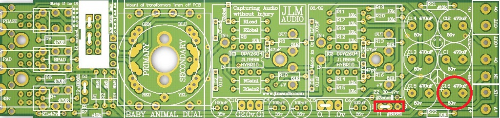

FIt BD681 at back of the BAD pcb (black plastic side closest to pcb edge)
Fit 100uF 50v to C16 instead of 470uF 50v cap to help new power supply start the Dual99v easier.

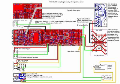

NEW Dual99v, BAD Overlay wiring Larger copy here
OLD Dual99v, BAD Overlay wiring PDF Larger PDF copy here

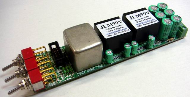

BAD PCB fully assembled except for 2 x 270R for RGain, input transformer and opamps Larger photo here
Notes & Errata#BD681 jumper is wrong in the photo below. Should be E-C. Also Dual99v does not use a Cload cap any more. So leave blank.
BAD PCB fully assembled as Dual99v (Note 2 links needed between centre pin and E on each BD681 position and 1mm gap under transformer)

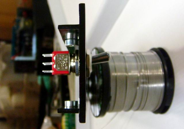

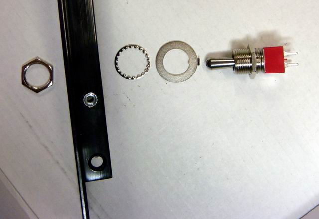

Sit toggle hard against the PCB and solder one front support leg on each toggle to hold in place.
Check toggles level and square to each other and solder all legs and support pins
Dis-guard flat washer and fit the rear nut (should be a few mm gapped from the end of the thread) and washer to all three toggles
Nuts should just screw on an tighten with minimum thread sticking out if the rear nut is set correctly
Nuts and washer order for Power switch
Same again space the rear nut up so the minimum of thread sticks out past front nut.

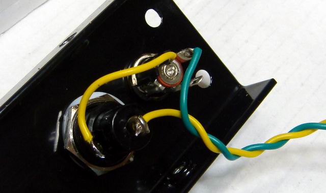

DC connector and Fuse wiring

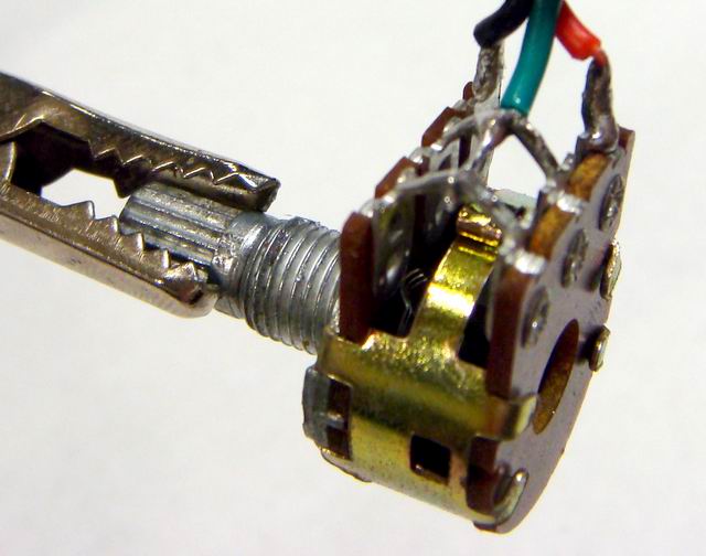

All Pot wiring for BAD Dual99v PCB

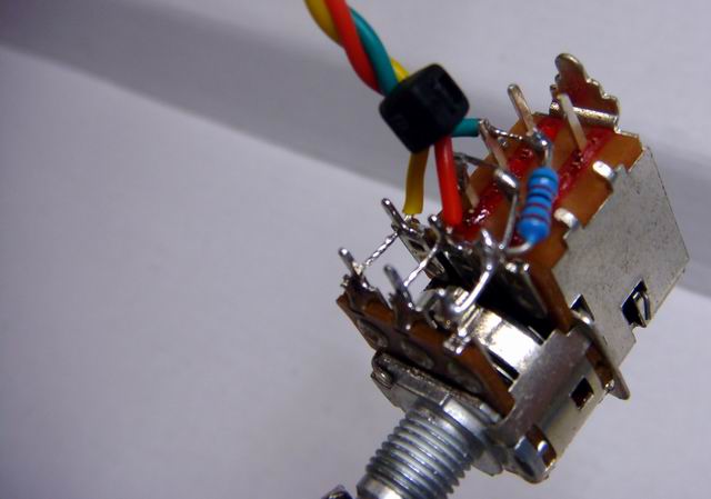

Gain pot wiring (Photo shows BAD/Dual99v dual pot)
Note BA is the same but only a single pot
Output Pot wiring
Z pot wiring

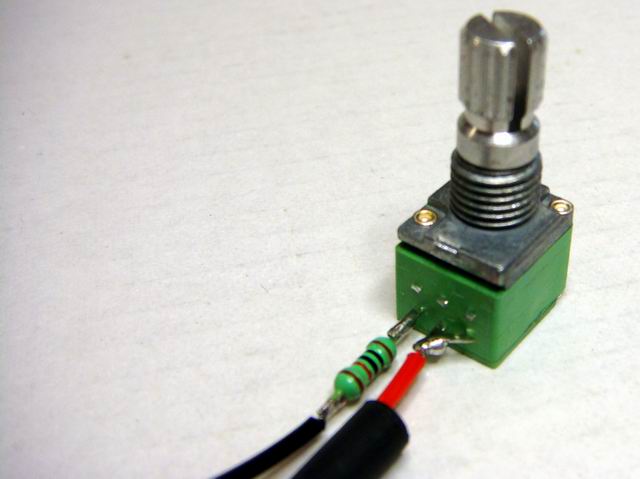

OEP/VTX = 10k in series with 100k log pot. (As shown in photo below for Dual99v)
JLM14 = 2k2 in series with 50k log pot (2k2 resistor solders to both pins on the left and red wire solders to all 4 pins on the right)

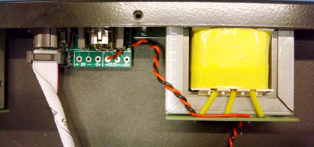

Output transformer to IOXLR PCB (Note link wire between -2 and +3 is hidden in this photo)

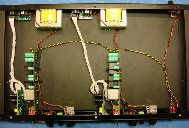

Full Dual99v internal wiring Larger photo here

HI Jason
This is the SMPS power supply going into hiccup mode protection mode. Modern green high efficiently SMPS go into this mode almost too easily. Especially if charging some large capacitors when powering up. Did you happen to do the Notes and Errata changes at the top of this thread? C16 should be 100uF and BD681 at back fitted to give soft start.
Also always best to power one channel at a time in case there are any problems or shorts with one channel. Just removing the +48v from the BAD pcb one one side is all that is needed.
If stuck send me some clear large in focus photos of the top and bottom of the PCBs to check for you.

Thank you for the quick reply! I did not fit the 100uf or bd681. Does this mean I should also fit R21 as well?
Thank you,
Jason
Re: Dual99v Rack kit build thread 2024
seeker wrote: ↑
Tue Sep 24, 2024 11:55 am
Thank you,
Jason
Yes correct R21 10k is needed

Hey Joe, so I installed c16 = 100uf and bd681and R21 = 10k. When the two channels are both hooked to 48v, I get the same pulsing power light, and you can hear the relays flicking on and off. So I detached the 48v from one channel at a time and no pulsing lights... Then I checked each channel individually with a dynamic mic and a guitar through the DI. Both channels seem to be perfect on their own...

If you unplug 1 or 2 of the FETDI 10-pin plugs does the 2 preamps power up ok?

So if I unplug Channel A DI, I get two pulses from the power supply then it seems to be fine (though I did not listen to output) however if I instead unplug channel B DI and leave A plugged in i get the same pulsing as before.
Unplugging both DIs the power light seems to pulse once or so and then stay steady.

Sorry I was away for the day. Testing just now with this new batch of 25w smps on 115vac it seems we have to go back to the original soft start mod.
Cut track and add wire as shown and mic pre should power up. Let me know how this goes.

Thanks for the help Joe, both channels now power up and sound great! :D Ive only played with it for a few min but I'm very impressed.

Here’s a few pics… the lighting is bad, but I’m pretty happy with the build….
And I’m very thankful for your quick replies!
If you need a beta builder in the US, let me know!

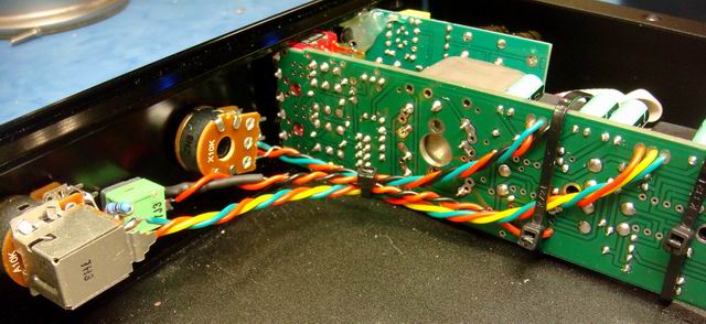

If you can do a loop test with free RMAA rightmark or Plugin doctor and send me the sav file for RMAA or image for plugin doctor and can check if it looks to be working correctly or not. Set minimum CCW gain and pad on and level on fully CW.
Any change at full gain will be oscillation so make sure the ribbon wire is twisted tightly and in and out wires and Z pot wires spaced apart from each other.
