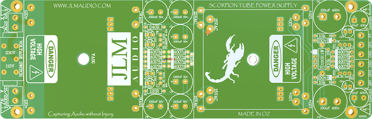

DANGER HIGH VOLTAGE EVERYWHERE ON THIS PCB. ONLY QUALIFIED TECHNICIAN SHOULD WIRE THIS POWER SUPPLY
150v or 300v High voltage out is set by J1. Centre 2 pins 2-3 linked for 300v and outside 2 pairs 1-2 & 3-4 linked for 150v.
Also for 150v only one 150v zener is fitted the the other is replaced with a wire link.
If you want the high volts rails to sag like vintage gear do not fit any 150v zeners.
Scorpion 30w wattage calc
300v high voltage setting = 21 x Filament current + 320 × HV1 + HV2 current = 30W or less.
150v high voltage setting = 21 x Filament current + 160 x HV1 + HV2 current = 30W or less
Build map for top of scorpion pcb
https://www.jlmaudio.com/builds/maps/ScorpionPCB.html

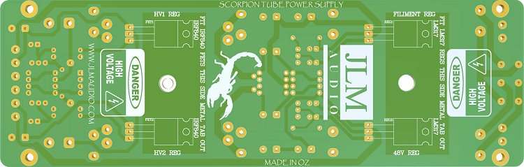

Build map for bottom of scorpion pcb
https://www.jlmaudio.com/builds/maps/ScorpionReg.html
Regulator and FET TO220 mount with metal tab away from pcb and are covered by silicon thermal tubes before mounting to case.
