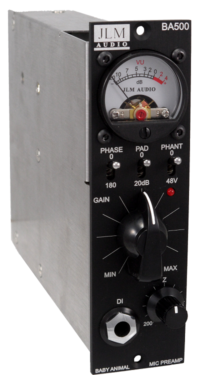

Please feel free to ask for any extra info you need while building on this thread so I can add it here.
The BA500v2 is a 500/51x version of our well know Baby Animal mic pre.
