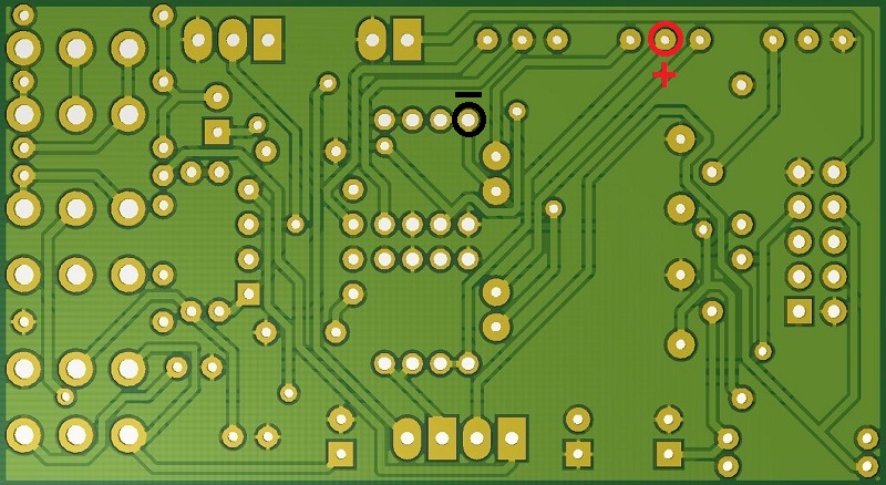

Trim and solder one end of the red and black wires
Red and black wire solders to points on the MAC PCB shown below.
Trim and pre solder wires so black reaches the threshold pot terminals with the -cap lead and red reaches switch terminals closest to the threshold pot as hsown below.

Post by saxmonster »
Nico,
It looks like your black wire coming off of the new Capacitor is not going to the same spot on the PCB as Joe's black wire is, in fact it kinda looks like there might be a soldering bridge there too with the soldering point above it. Hot solder might have dripped down causing it to bridge.
Also your red wire going to the leads on the threshold should be bridged I think. Just like originally but now that I look at it it looks like Joe snipped the bridge between the two front leads on the threshold pot but there is no mention of it. Maybe it just looks like it is snipped. The two leads closest to the knob. Please confirm Joe.

Other wires are in the way so cannot see where both wires are soldered to the PCB
