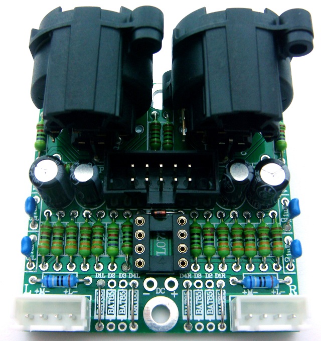

Build from the lowest height component to the highest. eg BAT85 diodes, Resistors, IC socket, 1uF caps, 4 pin headers, IDC10 header, 10uF caps, XLRs.
PCB built for July 2025 onwards 5v led lamp meters.
When using our New July 2025 JLM Large VU meter or any of our SEW VU meters do the mod shown below to get perfect dB scale
The 2 x RLAMP resistors = 680R and 4 x BAT85 diodes & 4 x 1k8 resistors & 2 x 100R are fitted as shown.
PCB built for 2022 - June 2025 5v led lamp meters.
47k = Yellow Violet Black red
3k3 = Orange Orange Black Brown
100R = Brown Black Black Black
10R = Brown Black Black Gold (Cream Body)

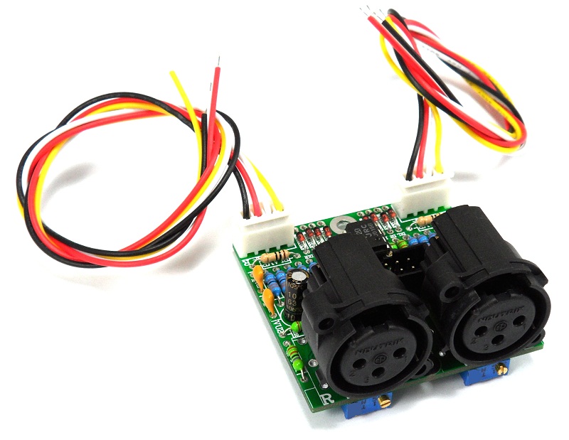

Fit Female XLRs. Then fit pot so screw to the right from front under PCB as below photo shows.
Fit TLO72 IC so its end notch and pin 1 dot are closet to the XLRs. Trim 4 wire cables to half there length.

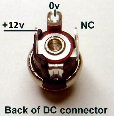

Use one off cut red and black wire to wire the +/-DC on the VU2 PCB to the DC connector.

Wire meters to 4 wire cables as shown and plug them into the VU2 PCB.
