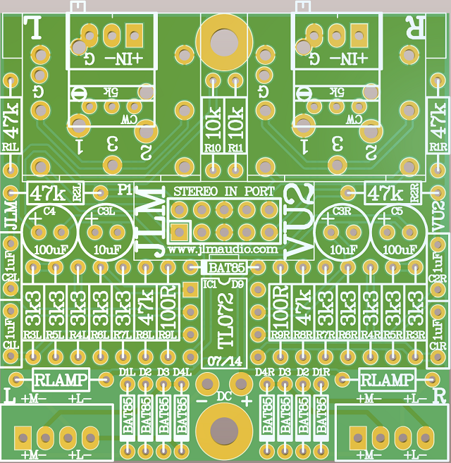

VU2 stereo VU buffer PCB
PCB can be power using the +/-DC solder pads or the IDC10 header as used on our AMP HEAD kit.
If using single rail +DC can be +12v to +36v and -DC wired to 0v.
If using dual +/-rail +DC can be +6 to +18v and -DC can be -6 to -18v. (NO 0v power rail is connected when dual rails are used)
47k = Yellow Violet Black red
3k3 = Orange Orange Black Brown
100R = Brown Black Black Black
VU2 Stereo buffer kit parts list here
INPUTS
3 OPTIONS (You can also have XLR and TRS at the same time by adding a Stereo in kit.)
XLR PCB Mount (one for left and one for right channel)
TRS PCB Mount (one for left and one for right channel)
3 pin connectors (one for left and one for right channel)
IN+ = + Balanced input signal (Unbalanced + input) (Red Wire)
IN- = - Balanced input signal (Unbalanced shield) (Black Wire)
G = 0v ground shield (Not used for unbalanced input) (Yellow Wire)
OUTPUTS
4 pin connectors (one for left and one for right channel)
M+ = Meter + terminal (Yellow wire)
M- = Meter - terminal (White wire)
L+ = Lamp + terminal (Red wire)
L- = Lamp - terminal (Black wire)

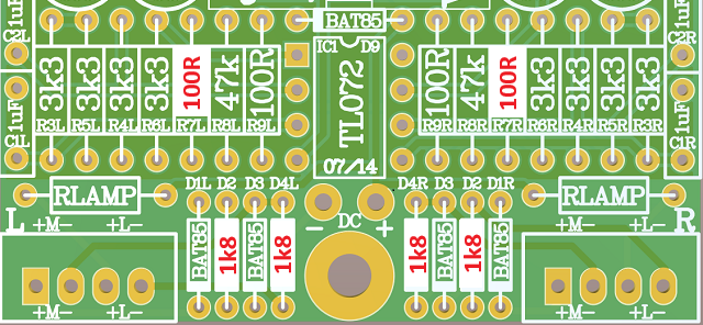

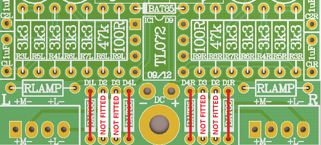

Note 1. When using our New July 2025 JLM Large VU meter or any of our SEW VU meters do the mod shown below to get perfect dB scale
Note 1. When using a meter with internal rectifiers do the mod shown below to disable the VU buffer rectifier.
Note 2. If trimpot is fitted the opposite way to what the overlay shows buffer it will work fine but gain will increase counter clockwise.
Note 3. If you need more gain change R7L & R7R from 3k3 down to a minimum of 100R. It is also then worth putting a red LED or or 2 x 1N4007 in series across the meter +(Anode) /-(Cathode) terminals to limit & protect the meter in overload conditions. You can also get more gain by changing R9L & R9R from 100R down to minimum of 22R or 10R.

The 100uF cap to slow the attack and release of the meter can be any 100uF 6v or more.
THE VU2 10pin Header STEREO PORT is the same on our AMP HEAD & STEREO IN PCBs
STEREO PORT
Pin 1 Left Audio +
Pin 2 Left Audio -
Pin 3&4 V+ = DC +
Pin 5&6 0v = GND
Pin 7&8 V- = DC -
Pin 9 Right Audio -
Pin 10 Right Audio +
