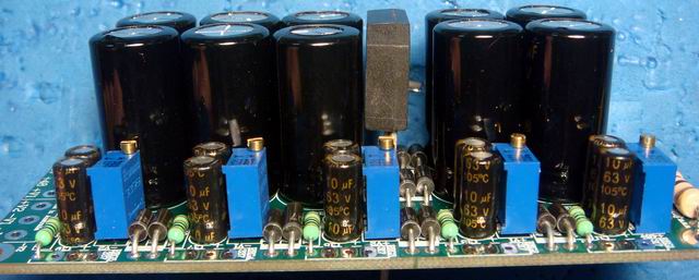

4. Install the 5 x 5k trims pots with adjust screws closest to the large caps as shown.
5. Install 10 x 10uF 63v caps all with there positive long leg to the left as shown.
6. Install the 3 x LM317 positive regulators in the 3 left positions and the 2 x LM337 negative regulators in the 2 right positions. Now is a good time to use the mounted regs to mark up the 5 mounting holes in the heatsink or metal case side panel. You can also put the regulators legs in from under the PCB if you want to bolt the regulators to the same surface as the PCB mounting holes
(AC/DC has 2 x LM317 to the left and 1 x LM337 to the right)
7. Install 10 x 1000uF 50v caps all with there positive long leg to the top as shown.

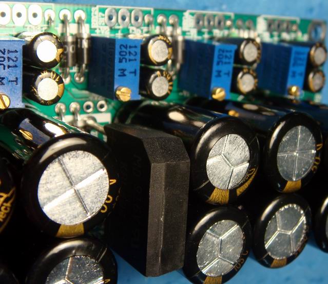

Photos of 4Amp or 6Amp bridge fitted to Powerstation Ver 3 PCB. Leave out D1 to D4 if using 4A bridge.
(Fit the Bridge so it stands with its top at the same height as the 1000uF caps as shown below)

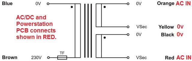

Sometimes the in phase wire of the secondary windings are shown with 0v which can be confused with the PCB 0v but it must be wired to the AC/DC or Powerstation kit as shown below.
