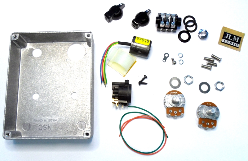

First unpack kit and check you have all the parts below. Plus box back panel not shown in photo.

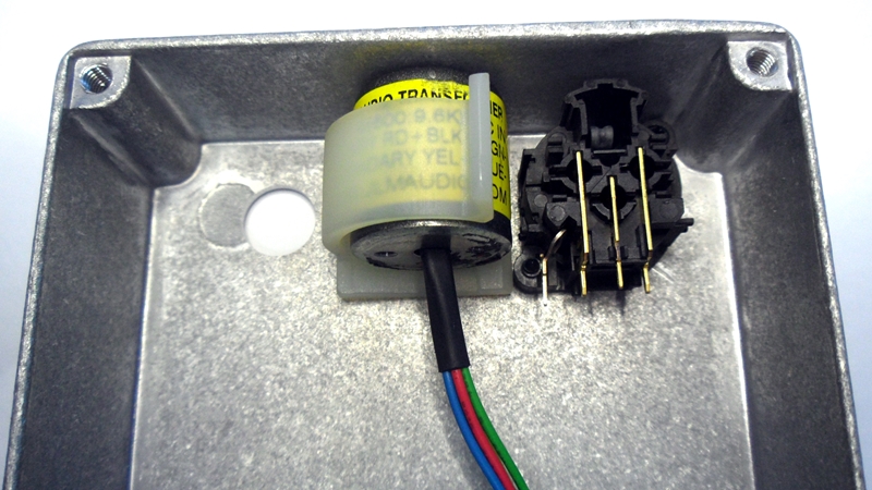

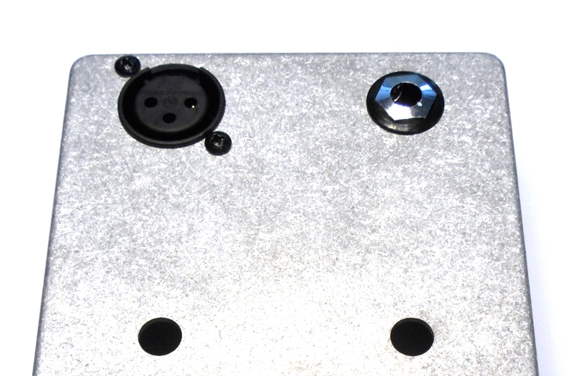

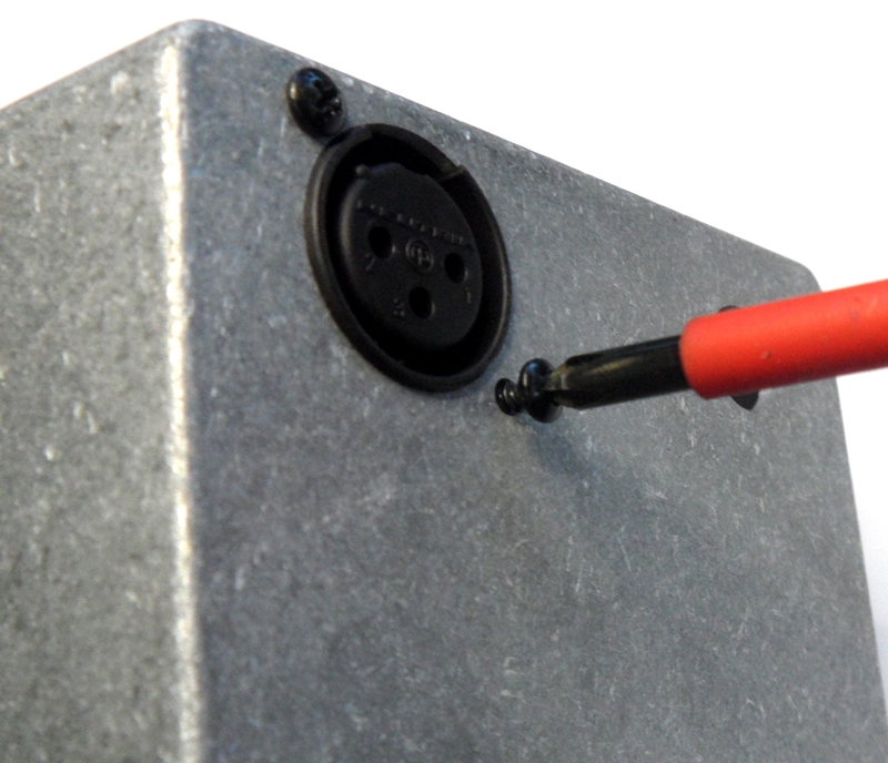

Start assembly by fitting the Female XLR inside the case.
Use the 2 black self tapping screws to hold it into position.

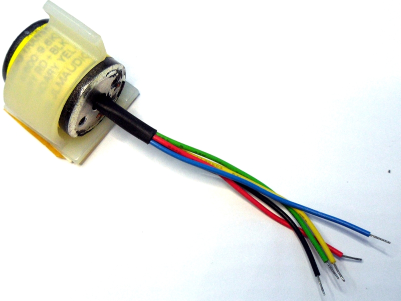

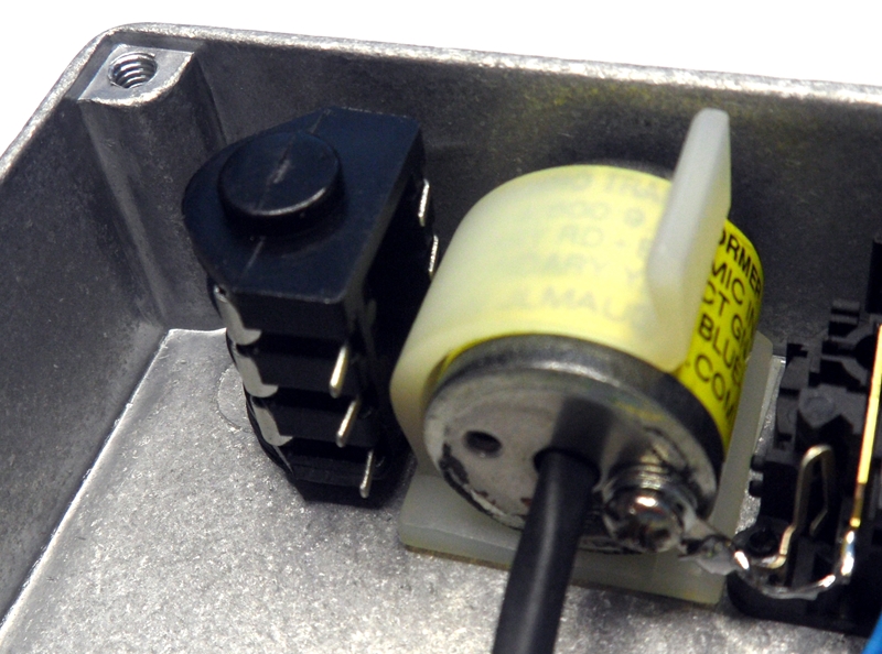

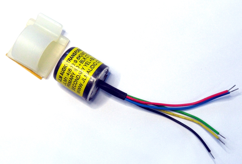

Fit JLM14 transformer into plastic clip
Remove protection plastic from double sided tape on clip
And stick to box hard against the top edge and as close to the XLR as possible

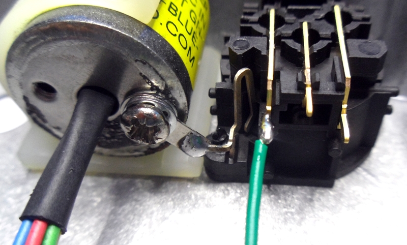

Screw ground lug to transformer with lock washer, ground lug, lock washer and 3M 6mm screw in that order.

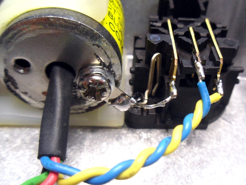

Fold ground tab on XLR 90 degrees and solder to transformer ground lug.
Pre solder XLR pin 1 and strip the end of the spare green wire and solder to XLR pin 1
Cut green wire about 10mm away from solder and slide off green plastic.
Twist wires and solder to XLR ground tab.
Pre solder XLR pin 2 and pin 3. Twist blue and yellow wires tightly and solder Blue wire to pin 3 and Yellow wire to pin 2.
Fold legs of TRS jack as shown below and fit the 2 fibre washers.
Fit into hole in case.
Use black dress ring and chrome nut to tighten to case.
Pre solder the 3 legs sticking out of the TRS Jack.

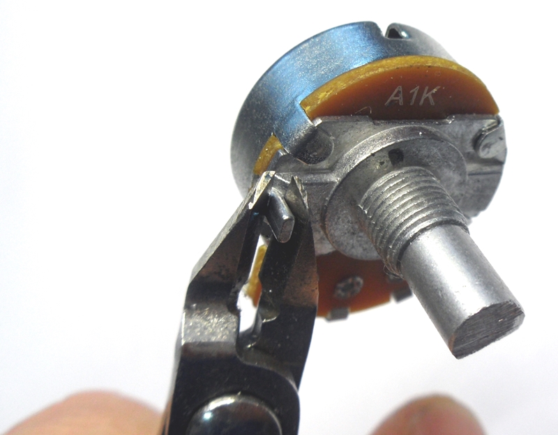

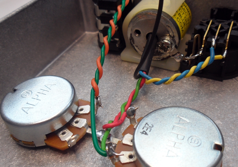

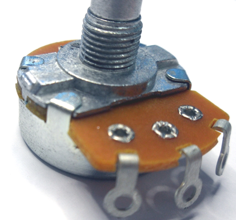

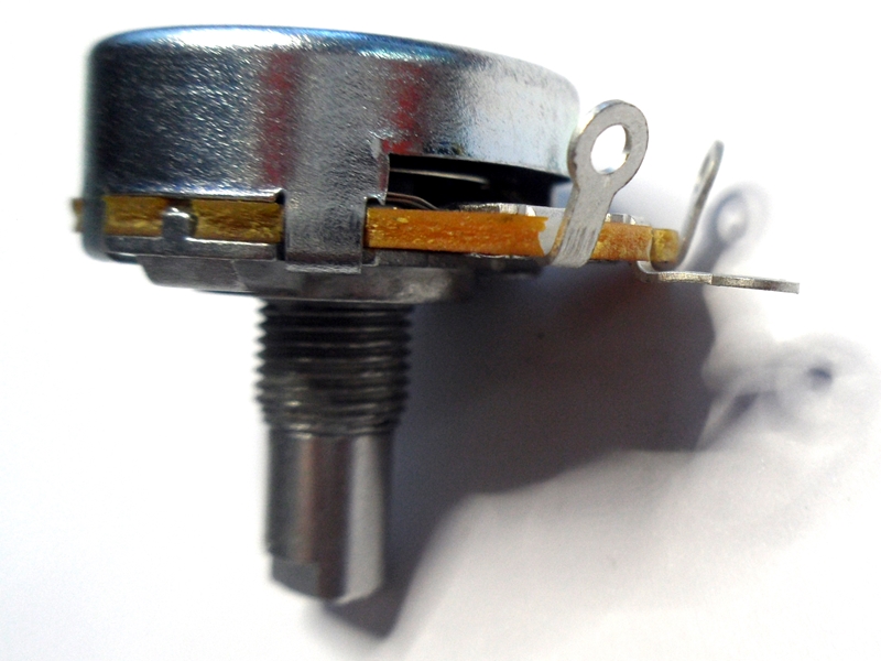

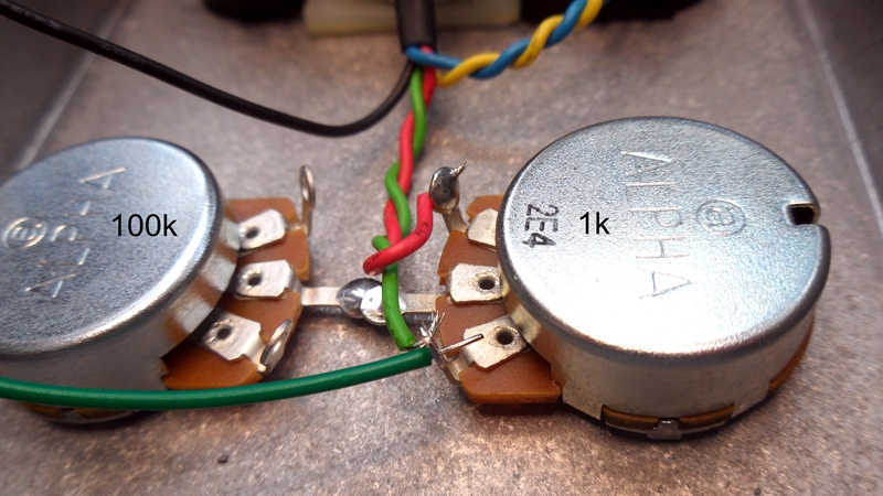

Cut pot locating tabs from the 1k and 100k pots.

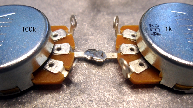

The 2 pots will go into the case as shown with 1k on left and 100k on right looking from on top.
It is worth writing the pot values on there back covers as you will not be able to see these values once fitted in the box.
Fold centre wiper lug down as shown on both pots.
Fit both pots as below and by adding the washer and nut to each and tightening down.

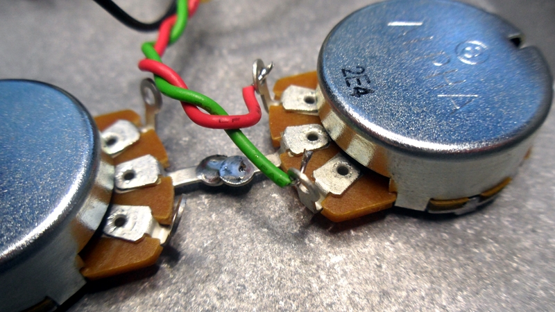

Solder pot centre wiper lugs together.

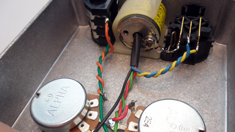

Tightly twist transformer Red and Green together and wrap tinned wire ends to 1k pot as shown.
Solder Red wire to volume pot lug. and add second stripped and soldered green wire supplied into volume pot lug with transformer green wire.
Solder both green wires in the volume pot lug.
Strip and solder end of orange wire supplied to impedance pot lug as shown.
Twist orange and green wires together.

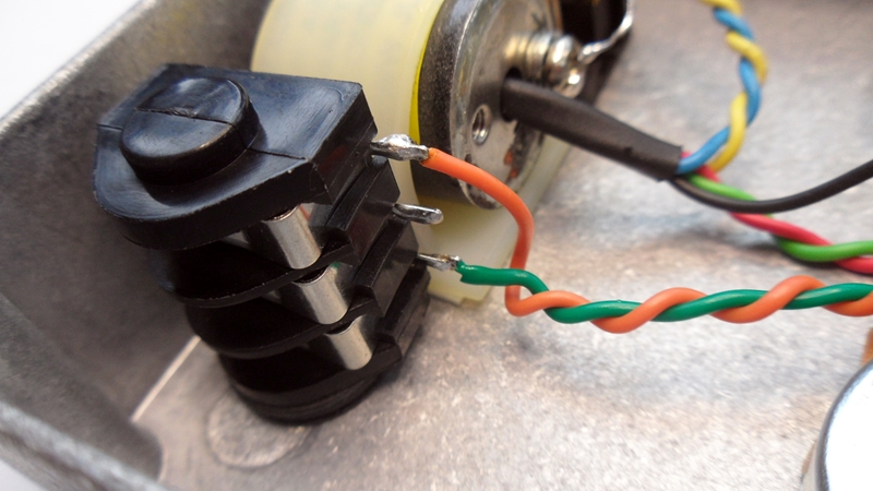

Cut twisted orange and green wire down in length so they reach the jack terminals with a bit to spare. Strip and solder both wire ends.
Solder green wire to bottom TRS jack terminal. And solder orange wire to top TRS jack terminal as shown.
Cut black wire shorter and slide end back into the black heatshrink tube so it will not short to anything.

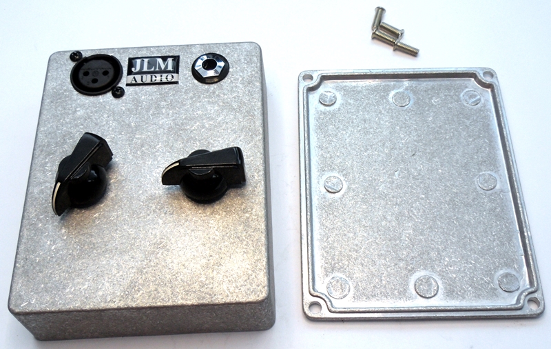

If the box works and you are not going to paint it now it is time to fit the knobs, logo, labeling & back of box.
Labeling can be done with dymo/brother labeling or by hand with permanent pen.
You could use any of the terms listed LINE INPUT = INPUT = IN. AMP OUTPUT = OUTPUT = OUT. VOLUME = LEVEL. IMPEDANCE = Z. etc

Post by Blackwolf87 »
Hey Joe,
Just build the reamp box, but it doesn't work, if you could please help me out.
The output from the box is very low, level and impedance control doesn't react at all.
Checked and rechecked every connection, checked for shorts, but it seems all right.
I've build 2 PEQ500A & 2 LA500A with ease...
Thank you
Re: REPRO Passive reamp Box Build Thread
Blackwolf87 wrote: ↑
Mon Nov 11, 2024 6:54 am
Hey Joe,
Thank you
You are soldered onto the wrong side of the TRS jack pins. You are connected to the lift switch side pins so when plugging in a jack it will discount the output. Turn the jack 180 degrees and move the green and orange wire to the same place but on the other side of the jack. See photos at top of build thread to see the difference
