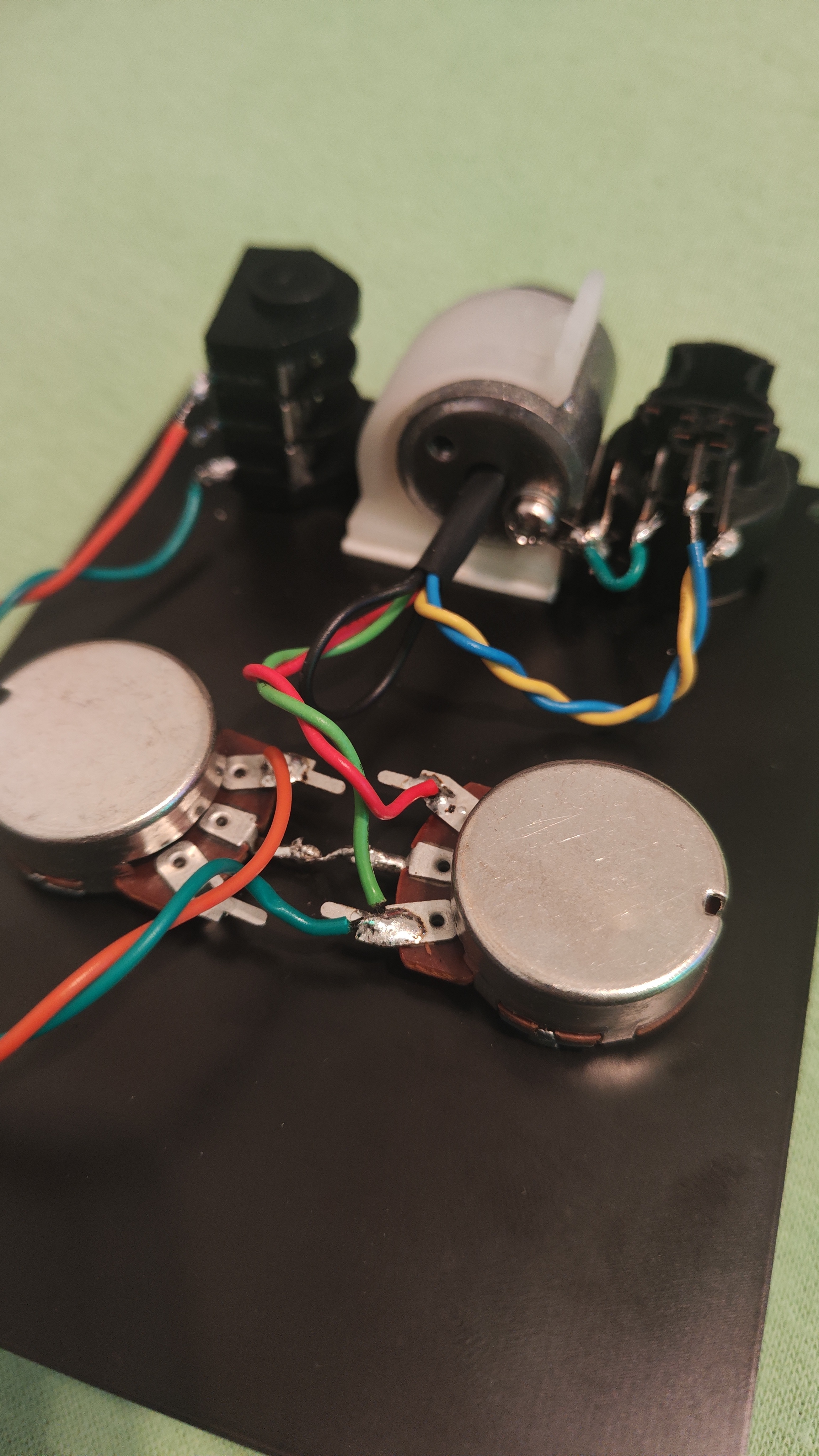

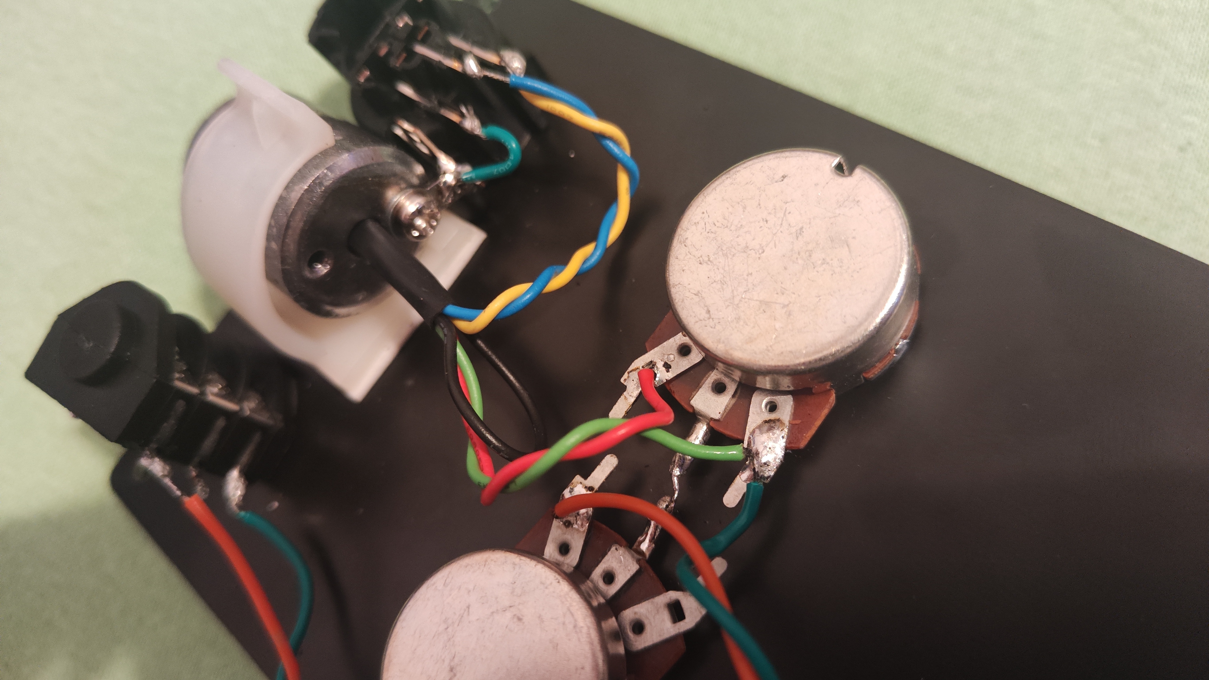

Hey Joe,
Just build the reamp box, but it doesn't work, if you could please help me out.
The output from the box is very low, level and impedance control doesn't react at all.
Checked and rechecked every connection, checked for shorts, but it seems all right.
I've build 2 PEQ500A & 2 LA500A with ease...
Thank you

You are soldered onto the wrong side of the TRS jack pins. You are connected to the lift switch side pins so when plugging in a jack it will discount the output. Turn the jack 180 degrees and move the green and orange wire to the same place but on the other side of the jack. See photos at top of build thread to see the difference
