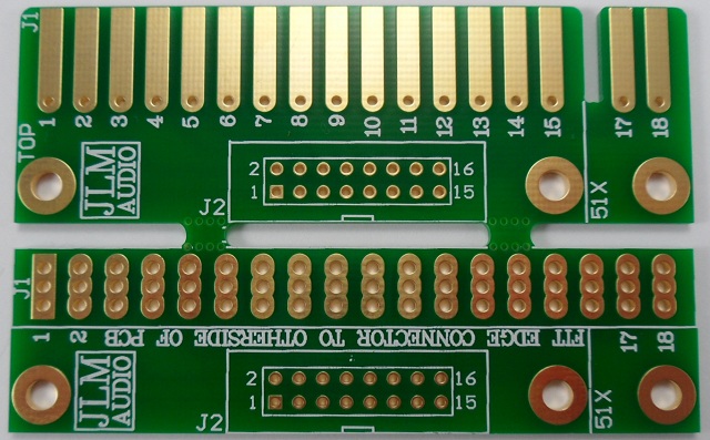

Pair of PCBs to make 500 / 51X Extender cable for building and testing 500 / 51X modules outside of the powered rack frame.
(Photo above shows 51X version. Below shows cut down 500 version)
PCB are double sided gold plated. PCB's are simply snapped by hand into 2 pieces and jointed with 16 pin IDC headers, plugs and cable.
Kit is available as kit or built and tested here
PCB is available here
Kit parts
1 x PCB pair
2 x 16 pin IDC headers
2 x 16 pin IDC plugs
1 x 300mm 16 wire ribbon
1 x 15 way (500) or 18 way (51X) edge connector
Build instructions
1. Solder 2 x 16 pin headers to PCB as shown on the overlay with their key way opening as shown on the overlay.
2. Snap PCB in two halves.
3. If building 500 version cut along white lines with sidecutters to remove 51X section.
4. Fit Edge connector as PCB says to UNDERSIDE of the PCB and solder on the overlay side of the PCB.
5. Make ribbon cable up with red stripe at same end of 16pin cable plug that has the triangle shape. Cable can go in from either side as long as red stripe is at the same end as triangle.
Squeeze the cable plug on to the cable with a vice is the easiest way. Fold the cable back over the top of the plug and fit the strain relief clip with just finger pressure. Do the same for the other end of the cable.
6. Plug in cable to join the 2 PCB sections and use a multimeter to make sure pin 1 to 16 on plug line up with pin 1 to 16 on edge connector. (Pin 3 is no used so has no connection)

Re: 500/51X Extender Cable Build Thread
Post by Ben6765 »
My kit appears to be an updated layout that includes an LED for power indication.. does the long LED leg go to the square solder pad?
Thanks!
Ben
Ben6765 wrote: ↑
Tue Dec 31, 2024 12:38 am
Thanks!
Ben
Yes we added a led. Yes anode long leg is the square pad
