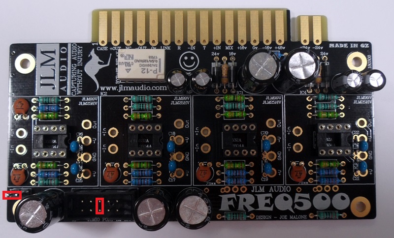

FREQ500 Audio path pcb can be tested by itself by fitting a jumper shunt to pin 5 & 6 in the centre of the 10 pin header.
Then fitting a second jumper to TP1 will switch the pcb from bypass to audio path which should give the same level audio output.

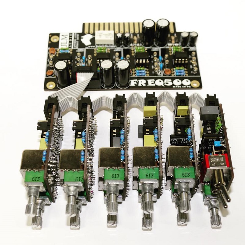

Snap v grooved pcb in half or 6 and fit the 10 pin right angle headers and solder in place
Snap into 6 if you haven't already and get leds, metal bracket and front panel ready to assemble
Stainless steel bracket fits perfectly into recess on rear of front panel
Looking at front of the pcbs cut of locate tab from pots on the right side of the pcb
Fit top hi pcb with left pot locate tab into stainless steel bracket and fit nuts only hand tight (we no longer use washers)
Bend one orange and one clear led short legs downwards to just less than 90degrees
Hold long legs with small pliers about 4mm away from plastic led and bend downwards to just less then 90degrees
The short K leg once bent will now look like it is the longer leg.
Fit the short (now long) K leg in the hole closest to the edge of the pcb marked K and other leg in hole behind marked A
Drop the orange and clear leds into the front panel holes.
Solder one leg of each led and check sitting correctly and not shorting to anything before soldering the 2nd leg.
Repeat this for HI MID, MID, LO MID & LO pcbs
Undo the hand tight nuts & remove the HI, HI MID, MID, LO MID & LO PCB
Fit the HPF pcb to bracket and front panel. Orange HPF led is the same as previous pcbs with K short (long once bent) leg to K on pcb.
The Yellow and blue leds are more complicated to bend. See below photos.
Make sure the led legs do not touch the switch metalwork or fit plastic tube over the legs.
K legs of leds are always at the front edge of the pcb and can be identified as the leg next to the flat side of the plastic led
Fit jumper shunts on to the preferred cut/boost dB amount per band
Add wire link to bottom of LO PCB (NO longer needed on newer pcb dated 240405)
Fit HPF, LO, LO MID, MID, HI MID, HI PCBs to front panel and bracket and do up nuts

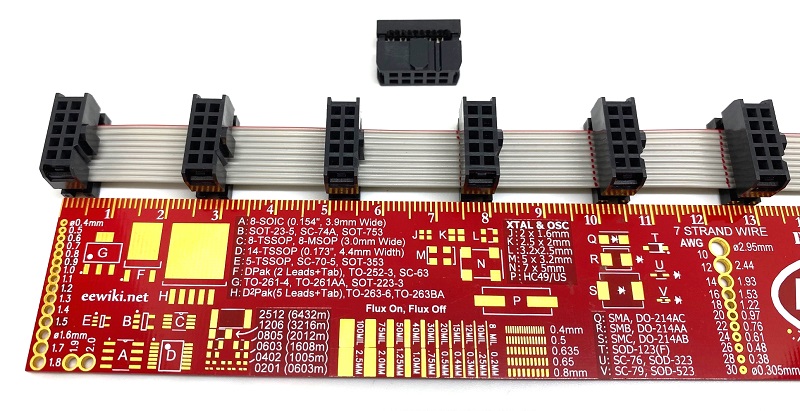

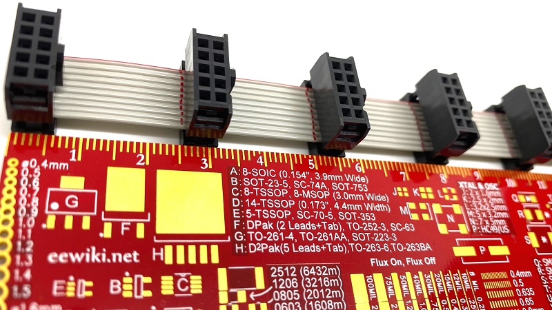

Make up ribbon cable. Red stripe to pin 1 triangle marker on plug.

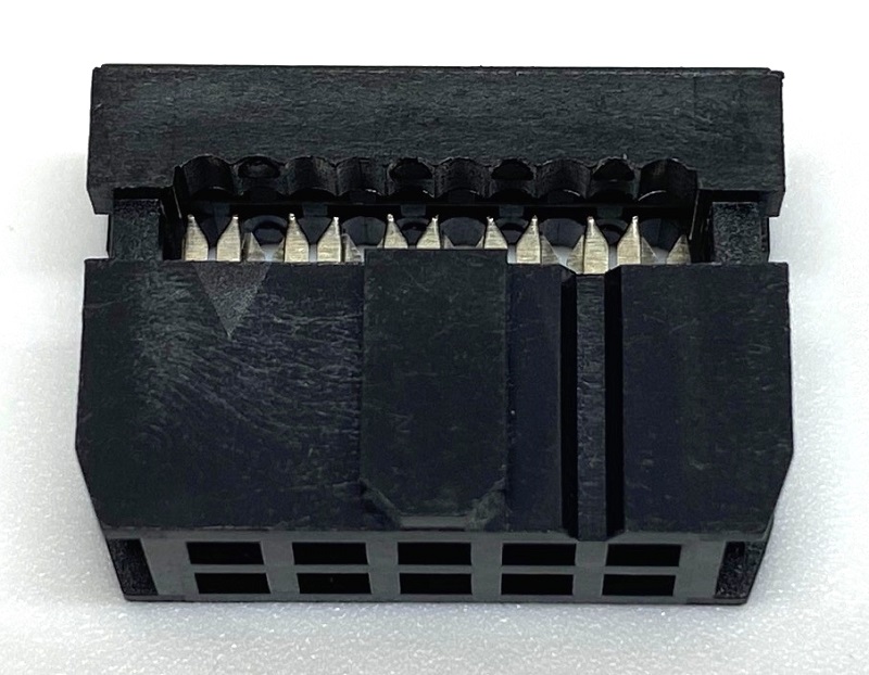

Hand press these plugs to the ribbon cable one at a time and use a vice to squeeze them fully down.
When testing you can get audio out of EQ with only HPF PCB plugged in.

Third most common is ribbon cables with IDC connectors not fully pressed on onto the cable. Use a normal bench vice to press IDC connectors on to cable.
