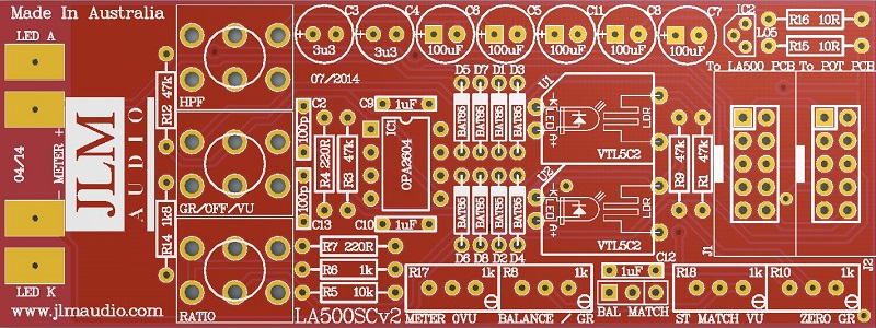

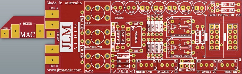

THE LA500SCv3 PCB is the MAC PCB but with no hand wiring and slow attack parts added
NEW LA500SCv3 PCB has extra MAC part so no meter wiring is needed in MAC rack kits
and some extra holes under U1 & U2 optos which are not used for now
MAC schematic at the link below is the same.
https://www.jlmaudio.com/MAC/MACSCH.pdf
LA500SCv3 PCB parts kit

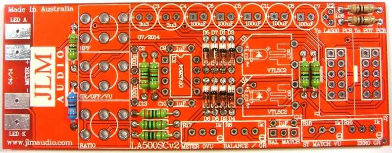

LA500SCv2 PCB. PCB overlay has all values and there are no options.
so PCB can be assembled directly from overlay.
Fit all 8 x BAT85 diodes with there Cathode POLARIZED black stripe matching the white stripe on the MAC PCB overlay
Solder all BAT85 diodes while holding PCB firmly upside down on flat surface. Make sure none of the center close pads are NOT shorted together.
Cut all diodes legs off at top of the solder joint and double check no solder joints missed soldering or are shorted together.
If you are not 100% with resistor colour codes use a multimeter to check values as you place the resistors
Fit all resistors at once bending the legs sightly outwards to hold them in place.
This helps to make sure no resistors are put in the wrong position.
Solder all resistors while holding PCB firmly upside down on flat surface.
Cut all resistor legs off at top of the solder joint and double check no solder joints missed soldering.

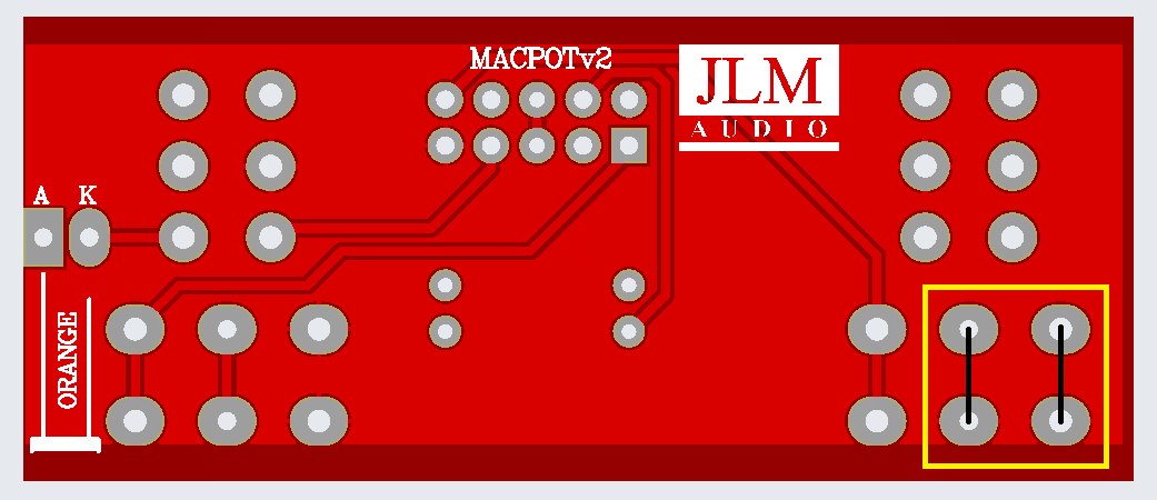

Note LA500POT PCB has been replaced with dedicated MACPOTv2 (needs 2 jumper wires added) & now MACPOTv3
Just build the MACPOT pcbs as their overlay shows as no mods or changes are needed.
MACPOTv3 has the 2 missing 0v ground on the makeup pot pins fixed so the 2 jumpers are not needed.

Which ones are the outside pins, I think the pots have two rows of three pins right? Also the one pot has a bridge on it right?
Posts: 2283
Re: MAC Rack kit Build Thread from October 2023 with slow attack led
saxmonster wrote: ↑
Mon Feb 05, 2024 3:56 am
If the voltages don't match turn off the comp and leave off for a while and measure the outside pins of the threshold and makeup pots still fully CCW.
(Like left threshold 95.76k and right threshold 102.54k and left makeup 9.33k and right makeup 11.11k. be as accurate as you meter shows)
Yes pots are bridged so measure the furthest apart pair of pads. Not the centre pads. If you measure front outside and back outside pads they should be the same if you soldering is good.

Sorry but I am still confused on the inside / outside part. Before I pull these boards out because I can’t reach the front six soldering points cause they are covered by the case lip. Can I measure from the back 6 solder pads on each pot? Are these part of the switch or the potentiometer? I have circled in white what I think I should measure. I don’t think the jumpers should be measured anyways. I have the macpotv2 pcbs.
Posts: 2283
saxmonster wrote: ↑
Mon Feb 05, 2024 1:51 pm
Sorry but I am still confused on the inside / outside part. Before I pull these boards out because I can’t reach the front six soldering points cause they are covered by the case lip. Can I measure from the back 6 solder pads on each pot? Are these part of the switch or the potentiometer? I have circled in white what I think I should measure. I don’t think the jumpers should be measured anyways. I have the macpotv2 pcbs. IMG_6893.jpeg
See attached. The back sections you have marked are the pull switch terminals. Front 6 pads are the dual pot terminals. If soldered correctly you should get the same value on the front two solder pads shown and the 2 solder pads behind them.
MACPOTv3 doesn't need the 2 jumpers in the yellow box.
