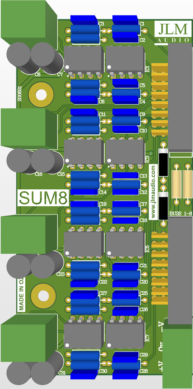

SUM8 pcb.
POTS are all 10k log either dual for stereo use or dual concentric stacked mono with odd on top. 1,2 3,4 5,6 7,8.
SUM8 BOM Parts list
1 x SUM8 PCB
4 x Dual opamp NE5532A, LM4562, LME49720, etc
2 x 18v Zener Diodes (only needed if using higher power rails or single power rail)
4 x DIP8 IC sockets
2 x right angle IDC 16 pin pcb headers
1 x 3way 5.08mm terminal block
2 x 10R carbon resistors
24 x 10k metal film resistors
16 x 47pF ceramic caps
8 x 1uF 50v mono caps
8 x 100uF 10v Non Polar caps
8 x dual or dual concentric 9mm 10k log pots

Hy i have recived pcb.
Can i get more info about this sum:
Which ic is used
Is er mouser or anders part number for 16pin plug and cable
Is there list for parts in this project?
Thanks in advance
Posts: 2283
Re: SUM8 Build Thread
znjamznjam wrote: ↑
Sat Jun 05, 2021 8:21 pm
Which ic is used
Thanks in advance
Added SUM8 schematic & BOM to first post
You can use any dual opamp like NE5532A, NE4562, LME49720, OPA2134.

Hey Jim,
I'm working on a small 8 channel mixing circuit based around a few CAPI boards and a few of your boards.
I'm using the SUM8 board as the backbone to my AUX send/return setup.
I have a couple general questions about mods to the SUM8 Circuit to suit my application.
My apologies if these questions are a little basic, my design background is limited.
1. Is it possible to achieve an inverted output on one stereo pair by removing and bypassing an IC and it's associated input resistor?
2. Is it possible to add gain to an amp stage by changing the feedback resistor. Something like 31.6K for a 10db boost?
3. So long as there is the 10K summing resistor before hitting the mix busses, will the inputs tolerate a range of unbalanced sources? I plan on keeping the aux sends and returns unbalanced and somewhere in the consumer line level gain range for use with reverb echo etc. (Maybe even a couple pedals) 4. Will not using the balancing boards cause me grief?
Thanks in advance for your help, as always, it's much appreciated.
-Stacy
Posts: 2283
spyder_hobo wrote: ↑
Sat Apr 22, 2023 7:55 am
Hey Joe,
Yes each summing stage has an invert stage to return it to same output phase. So if you bypass the invert stage you will be 180 degree out of phase.
Yes correct. Change the summing stage negative feedback resistor to larger to add gain
Yes the unbalanced inputs are passive 10k log pots so can handle any input level without overload just by adjusting the input pot to the level you need
The Palpigrade balanced input kit is active so can be overloaded but can handle +26dBu if run on +/-18v so really is no different as it will handle all balanced and unblanced level below that. Again set the input pot to get the output level you need otherwise the overload will be in the summing amp.
