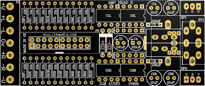

Note1: Current Ver1 PCB mono jumpers for pull pot doesn't work. All other functions work fine.
AMP HEAD II PCB. Size 3.35" (85mm) x 1.4" (35.55mm)
Image]
Fit all parts to pcb except zeners if not needed.
The 2 x *10R are 10R if powering with 36vdc and have 18v zeners fitted to the PCB. Or if using any +/-12v to +/-18v with no 18v zeners fitted.
Use step by step build map at this link https://www.jlmaudio.com/builds/maps/ampheadIImap.html

1.:For the 2 x 10r (RF+ & RF-):
I will run the amp head from +/-24vdc,Zeners omitted,I use OPA2604s.Must the value be changed?
Your instructions cover this topic as follows:
"The 2 x *10R are 10R if powering with 36vdc and have 18v zeners fitted to the PCB. Or if using any +/-12v to +/-18v with no 18v zeners fitted."
2.:The new AMPHEAD II has 2 inputs per channel now,great.Can I add up another one or two channels by simply adding them via 10ks (I have the schematics already,but maybe others are interested too)?
3.:It took a while before I found out what the hell the pads labeled R/B/Y meant.After receiving the kit it was clear…..colours for the phones o/p.
4.:I have my RG (L&R) on sockets now in case I will add inputs (via adjustable H-pads) to bring back some gain,learned it from my first AMPHEADs.
5.:For adding a mono/stereo/mute switch (DPDT toggle with center off position),can we use the procedure as described before in the old thread?
Link for reference:
https://www.jlmaudio.com/forum/viewtopic ... =165#p1430
6.:The build map is cool!
That´s it for today,
best regards,
Udo.
If you are running split +/-rails then no zeners are needed and 10R stay 10R.
Only if you were trying to drop say 48v (+/-24v) to +/-18v with 18v zeners fitted then the 10R would need to be made bigger ohms to set the current into the zeners.
Yes you can make like a normal 10k mix buss except this one is balanced so twice as many 10k. You will need 4 extra 10k for each stereo input.
This is what our STATTEN pcb and kit is made to do. You can ribbon cable lots of them together to make a volume & pan mix passive mixer into the AMP HEAD II.
Yes colour code for the prewired cables. R = RED TIP B = BLACK RING Y = YELLOW 0v
Link for reference:
Yes wired direct across the pot solder pads like original AMP Head. If you get null instead of mono reverse the 2 wires on one side of the switch.
Udo.
