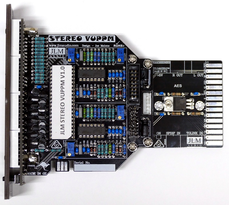

Both have been built and calibrated successfully! The build is pretty simple, even without step by step instructions. Ran into a few snags on the first build but the 2nd one was much faster to assemble. A couple of pointers:
Display PCB
1. Long lead of the LEDs go through the pad with a square.
2. Switches should be flush to the PCB, found it easier to force in the top pegs first, then then bottom pegs. Whatever method works is fine.
3. I found it easier to assemble the whole PCB in its entirety (including screwing on the front panels) then solder everything together. This made it easier to make sure the blue LEDs were flush to the front panel and also to hold the 8 multicolor LEDs together without having to check alignment/fit.
Edge PCB
1. For the voltage regulator I just bent the leads first then screwed it to the PCB. Added all other components then soldered all at once.
Main PCB.
1. Make sure the two small yellow 1uF capacitors go where the CPU is.
2. Pin Sockets - Solder the square pad, adjust properly, then solder the rest of the pins.
3. When joining the main PCB to the Display PCB, make sure to solder both sides.
Test/Calibration
1. I found it easier to set the level at around 75% instead of at 0dfs so I could visually see which direction the meter was going when turning the trim knobs. Once I figured out the correct way to rotate, I put it back to 0dfs and then calibrated according to Joe's instructions.
