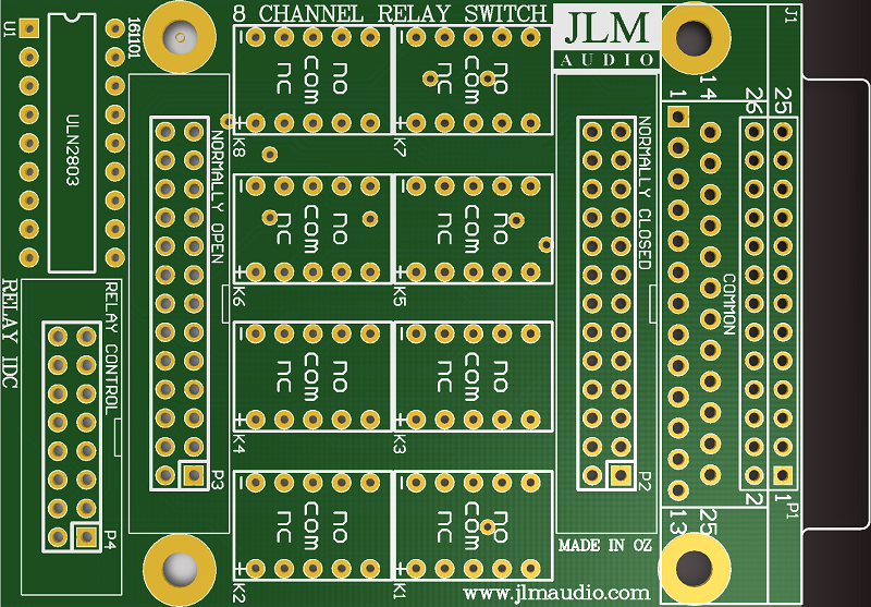

Version 1 PCB

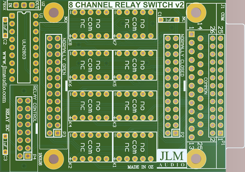

New Version 2 PCB
Schematic for Ver 2 PCB

Select option you are going to use and fit all parts to pcb in order shown in build map link below.
Option 1 - 26 pin IDC header JLM 8 BUS or option 2 - DB25 Tascam pinout.
Use step by step build map at this link https://www.jlmaudio.com/builds/maps/8_channel_relay_switch_map.html
If using 24vdc relay for example (V- could be 0v and V+ 24vdc) or (V- could be -12v and V+ +12v)
JLM 8BUS ribbon lays out directly into IDC DB25 type connectors as Tascam format as long as red stripe pin 1 of ribbon cable lines up with pin25 DB25 which is the second pin from the end. So pin 13 is left empty and ribbon cable pin 25 & 26 are not used and removed.
JLM 8BUS 26pin input/output (Same as on Passive Monitor Controller, DSUB4, TASCAM/IDC to XLR/TRS IN & OUT PCB/kits etc)
Pin 1 0v (Pin 1 Square pad on PCB)
Pin 2 Ch1-
Pin 3 Ch1+
Pin 4 0v
Pin 5 Ch2-
Pin 6 Ch2+
Pin 7 0v
Pin 8 Ch3-
Pin 9 Ch3+
Pin 10 0v
Pin 11 Ch4-
Pin 12 Ch4+
Pin 13 0v
Pin 14 Ch5-
Pin 15 Ch5+
Pin 16 0v
Pin 17 Ch6-
Pin 18 Ch6+
Pin 19 0v
Pin 20 Ch7-
Pin 21 Ch7+
Pin 22 0v
Pin 23 Ch8-
Pin 24 Ch8+
Pin 25 V+
Pin 26 V-
JLM 16 pin IDC relay control & power port
Pin 1 - 4 V- (Pin 1 Square pad on PCB)
Pin 5 Ch1
Pin 6 Ch2
Pin 7 Ch3
Pin 8 Ch4
Pin 9 Ch5
Pin 10 Ch6
Pin 11 Ch7
Pin 12 Ch8
Pin 13 - 16 V+
Connect Ch wire to V+ to switch relay from NC normally closed to NO normally open 26 pin 8BUS connector.
Enjoy.

kante1603
Posts: 86
Joined: Wed Jan 20, 2010 6:12 pm
Re: 8 Channel Relay Switch Build Thread
Post by kante1603 »
Hello Joe,
I‘ve ordered one of these kits (12vdc version),it is on its‘ way to me now.
I see there are two versions now and don‘t know which one I will receive.I‘m happy with either one.
Just in case it is V2:
1.:The added regulator is to add more stabilty (I‘m a bit concerned about 78xx type regs,personally had quite a few issues with latchup in my builds over the years)?
2.:If it is a 7812 (in my case) we will have to supply the board with ca. 15vdc or higher to start the reg. working,yes?
3.:What‘s the prefered physical point to hook up our dc feed wires,directly to Vin and GND of the regulator pins,maybe at the bottom pcb side?
Thank you in advance,
Udo.
kante1603 wrote:Hello Joe,
Udo.
HI Udo
It will be a version 2 pcb but with 12vdc relays just link over the reg position in and out with a wire.
To feed power in and 0v use the link the 4 wires at each end of the 16 pin ribbon cable for +V & 0v.
The other 8 wires will be your relay control inputs into the ULN2803. linking any of those wires to +12v will operate the relay.
kante1603
Posts: 86
Post by kante1603 »
Thank you for the fast reply Joe.
But I‘m a bit confused now.
When will we use the regulator (and corresponding caps)?
I understood how the control port works and would have gone to feed my dc in Version 1 exactly there-because of four linked pads on each side.In version 2 it seems to be two pairs each side for dc both pre and post regulator.
I‘m o.k. with linking them,but want to know what the purpose of the regulator is.
Udo.
kante1603 wrote:Thank you for the fast reply Joe.
Udo.
The regulator is for dropping the volts for the ULN2803 inputs. As when running 24vdc into the ULN IC it can heatup the ULN just because of the input reference resistors load.
The caps are always used.
kante1603
Posts: 86
Post by kante1603 »
Aaaaaahhhhhaaaahhhh! :D
That clears it up,thank you Joe.
So if we use 24vdc relais we use 24vdc as supply voltsge and put in a 7812 for the ULN 2803,right?
I think confusion came from the schematics.Because the dc feed to the relais is written as „V+“ which is after(!) the regulator.
I will find out when I receive the board by following traces anyway.
Thanks again,
best regards,
Udo.
mrclunk
Posts: 9
Joined: Wed May 22, 2019 10:41 pm
Post by mrclunk »
Hi,
just ordered a bunch of these boards for a tape machine switch over box.
What is the relay footprint for the PCB?
5.0mm pin spacing? 7.26mm wide?
thanks
Paul

HI Paul
See attachment drawing below for pin spacing details.

For anyone in UK NEC / Kemet / IMO EA2 series relays fit.
