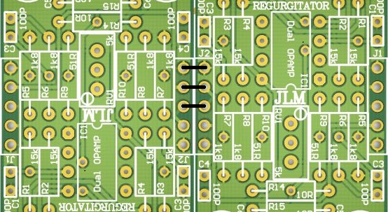

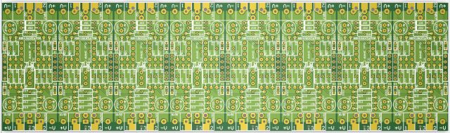

PCB comes as 8 x V groove snapable PCBs in one with side power connections already joined between the 8 PCB's.
Side power connections still line up when PCB sections are rotated 180 degrees. We can sell the PCBs still joined in 1 to 8 multiples.
Regurgitator 8PAK PCB. Size 8" (203.2mm) x 2.3" (58.42mm)
8PAK is V Grooved on top side and only needs 2 or 3 scores with a sharp utility knife
against a straight edge on the underside to cut the joining power rail tracks and
groove the PCB join so they seperate cleanly by bending the PCB section upwards.
XLR spacing is 1" (25.4mm) between joined PCB's

Power rail linking with reversed or seperated PCB's

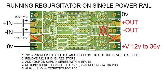

How to power Regurgitator Kit from a single power rail.

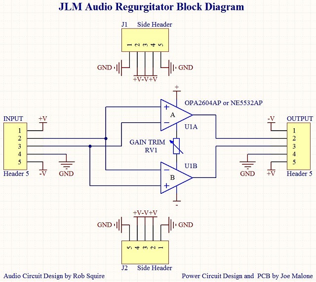

Is there a Schematic of the Regurgitator pcb w/component # and/or values ? If not could you please tell me what components are in the audio path and or the power path?

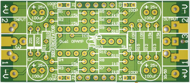

Yes I can email you a copy. Power parts are C7, C8, ZD1, ZD2, R14, R15. Everything else is audio path.

Please e-mail me the PCB Sch.

I like DI's to have a 1Meg input impedance so they do not load the instrument at all. So the input impedance is a bit low in the Regurgitaor. Unless you are running mainly active inputs into the DI inputs like synth etc then they would be perfect.
The PCB takes Neutrik A series XLR's. NC3MAH and NC3FAH. Also normal D series solder XLR's can push on each end and be soldered direct to the PCB but will need all the PCB's seperated as they will need to be 27mm appart where as the A series and PCB spacing is 25.4mm (1")
