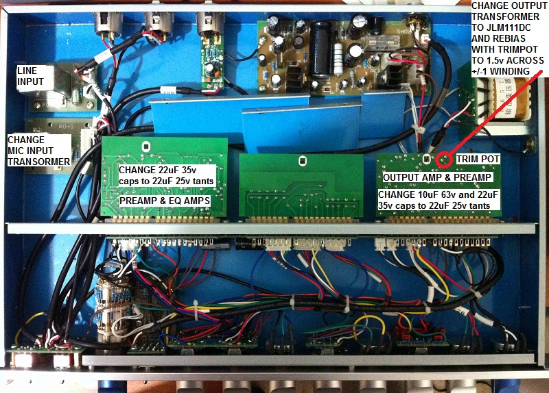

Overview of changes for CL7602 Mk2.
(Mk1 is the same except mic input transformer mounted on centre metal support panel with direct wiring no pcb and output transformer mounted on left hand side)

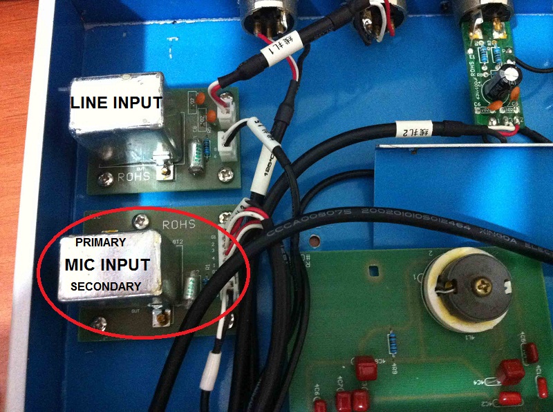

Find Mic Input transformer PCB

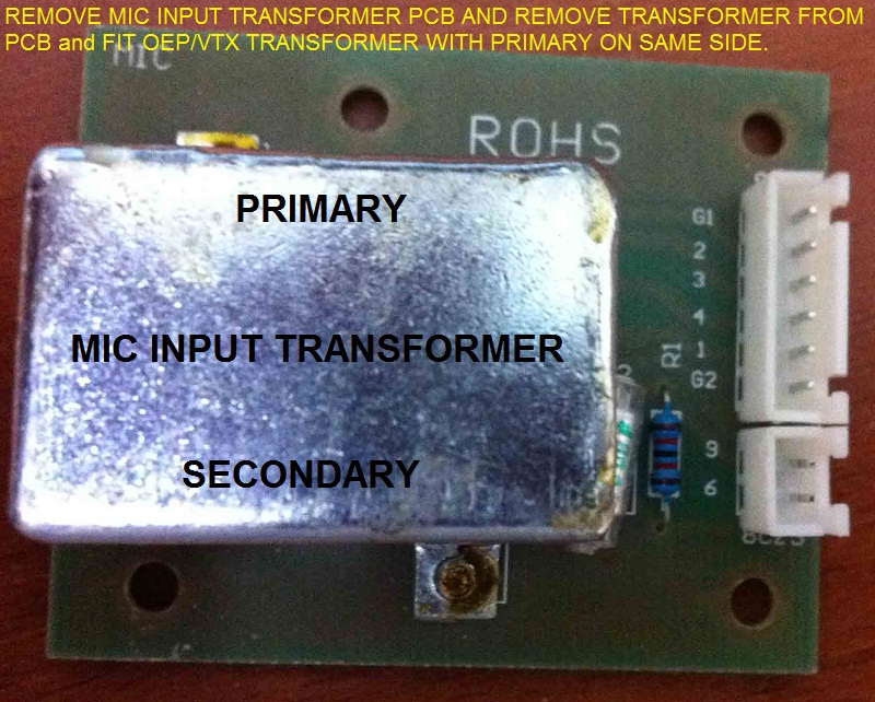

Remove Mic Input transformer PCB and remove transformer from it.
Replace with OEP/VTX with primary on same side a original transformer.

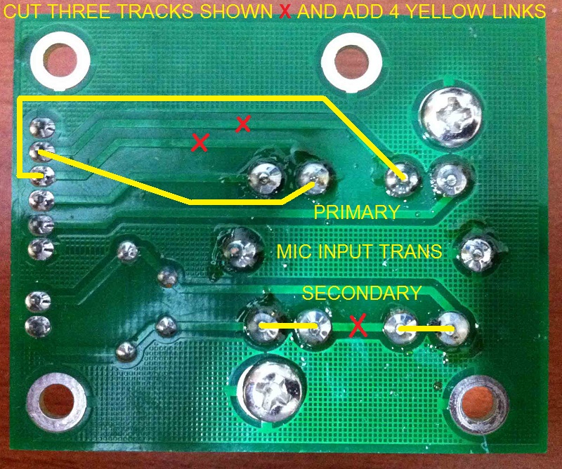

Cut 3 tracks as shown in red and fit 4 jumper wires shown in yellow.
Refit Mic input transformer PCB and retest CL7602 is working.
Remove card and change 22uF 35v caps to 22uF 25v tant caps.
(The very latest Mk2 versions should have tants already on this PCB)
Refit Preamp & eq amps PCB and retest CL7602 is working.

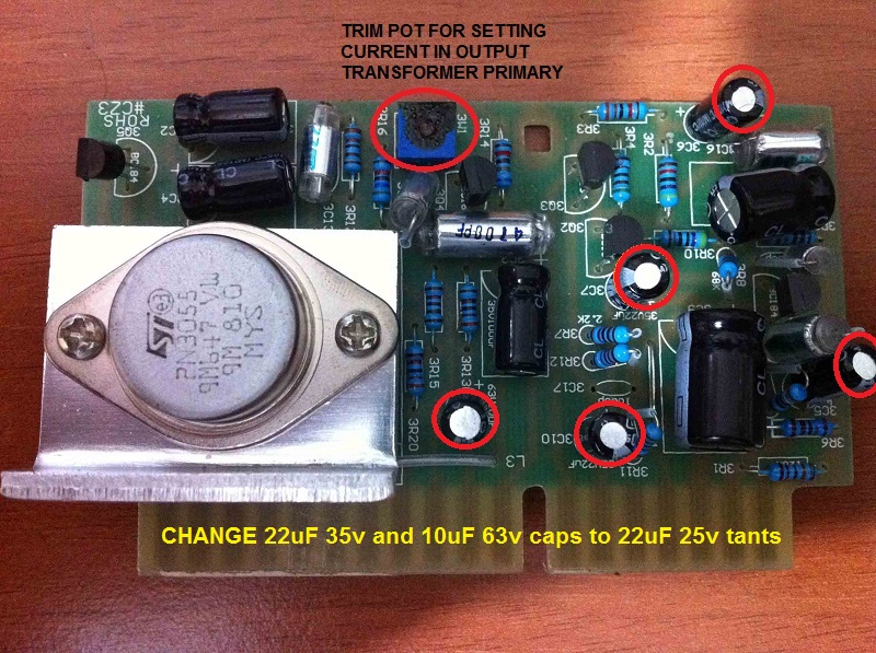

Remove card and change 10uF 63v and 22uF 35v caps to 22uF 25v tants.
Drill hole in bottom of case under trim pot to allow adjustment when card is refitted.
Refit Output amp & Preamp PCB and retest CL7602 is working.

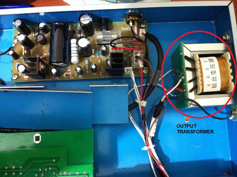

Find output transformer
Mark wires going to output transformer as shown and remove original transformer.
Fit JLM111DC transformer and reconnect wires to number shown.

Connect meter across JLM111DC +/-1 terminals and adjust trim pot for 1.5v. Enjoy :-)

sorry, I did not understand how to connect the wires to the output transformer, thank you!
Re: JLM Transformer mods for GAP 73, CL 7602 Mk1 and Mk2
ciscoheat wrote:sorry, I did not understand how to connect the wires to the output transformer, thank you!
The numbers shown on the above photo are the numbers on the JLM111DC transformer that the wire needs to be moved too so the old transformer can be removed. So best to add paper tape on the wires to write the numbers on all wires and remove the old transformer. Then wire the wires to the new JLM111DC transformer.
