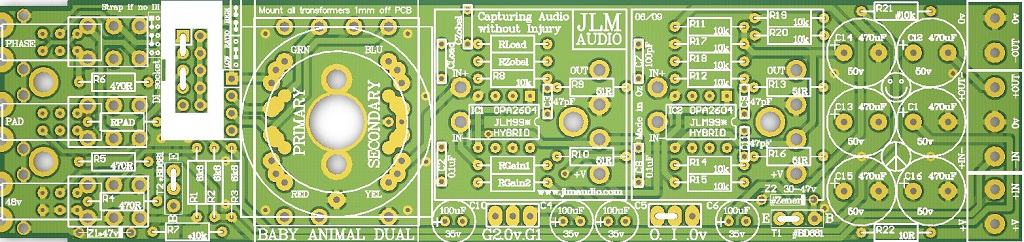

BAD PCB
Complete circuit of JLM Baby Animal Dual PCB here

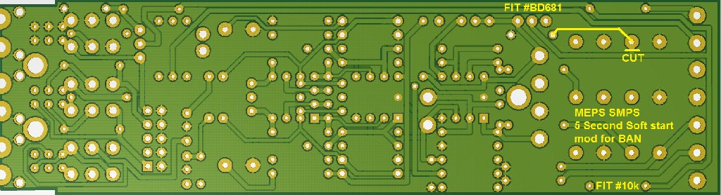

Note 1. The New 48v 520mA 25w MEPS SMPS external & 48v 315mA 15w internal SMPS power supplies under high capacitive and dc current power up surge can go into hiccup protection mode (power light will flick on and off) more easily than the old non MEPS ones so the below soft start mod is recommended for all new BA BAD BAN builds.
DO NOT DO THIS SOFT START MOD TO ANY NEW BUILDS. If building 3 or more BA kits use our 48v 40W SMPS instead as it can run 8 BA BAD or BAN easy
1. Do the soft start mod shown below. This leaves all parts fitted as normal but one track is cut and wire link added with #BD681 and #10k fitted. This gives 5 second soft start with no direct capacitance across the 48v SMPS and allows for the maximum possible BA BAD BAN combinations on one SMPS power supply. (#Zener is only needed as usual if opamp needs lower than 48v (+/-24v) rail.)
2. As always test each BA BAD BAN module on the 48v power one at a time without opamp fitted and test voltages and then with opamp fitted and test voltages to make sure the module is working properly. If one BA BAD BAN module puts the supply into hiccup mode there is a real fault.
3. While testing measure the voltage across the 10R resistor to see what current the BA BAD BAN module is drawing at idle (mA = V/10). Add up the total mA to check it is less than about 2/3rds of the specified current of the SMPS you are using to leave some headroom fro driving 600ohm loads.
4. Once all BA BAD BAN modules are tested to work correctly turn off and connect all the modules and power supply should powerup smoothly. If you are having problems email me with your exact configuration and which power supply you are using.
(Without mod each BA has 470uF and BAD abd BAN have 1000uF capacitance direct across the 48v rail which causes a short circuit for to long for the new MEPS SMPS)
BA MEPS SMPS Soft start mod (DO NOT DO THIS SOFT START MOD TO ANY NEW BUILDS. If building 3 or more BA kits use our 48v 40W SMPS instead as it can run 8 BA easy)
BAD MEPS SMPS Soft start mod (DO NOT DO THIS SOFT START MOD TO ANY NEW BUILDS. If building 3 or more BAD kits use our 48v 40W SMPS instead as it can run 8 BAD easy)
BAN MEPS SMPS Soft start mod (DO NOT DO THIS SOFT START MOD TO ANY NEW BUILDS. If building 3 or more BAN kits use our 48v 40W SMPS instead as it can run 8 BAN easy)

BAD PCB fully assembled except for 2 x 270R for RGain, input transformer and opamps Larger photo here
Notes & Errata#BD681 jumper is wrong in the photo below. Should be E-C. Also Dual99v does not use a Cload cap any more. So leave blank.

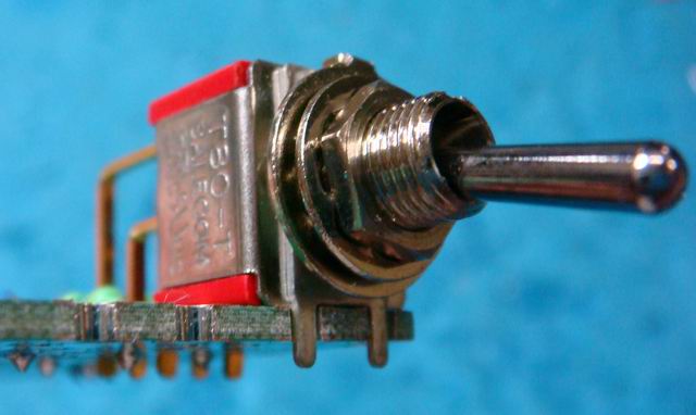

Sit toggle hard against the PCB and solder one front support leg on each toggle to hold in place.
Check toggles level and square to each other and solder all legs and support pins
Dis-guard flat washer and fit the rear nut (should be a few mm gapped from the end of the thread) and washer to all three toggles
Nuts should just screw on an tighten with minimum thread sticking out if the rear nut is set correctly
Nuts and washer order for Power switch
Same again space the rear nut up so the minimum of thread sticks out past front nut.

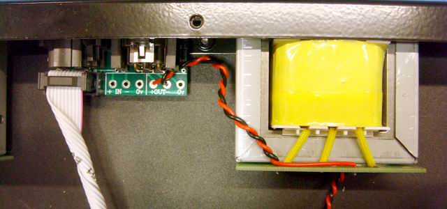

Output transformer to IOXLR PCB (Note link wire between -2 and +3 is hidden in this photo)
