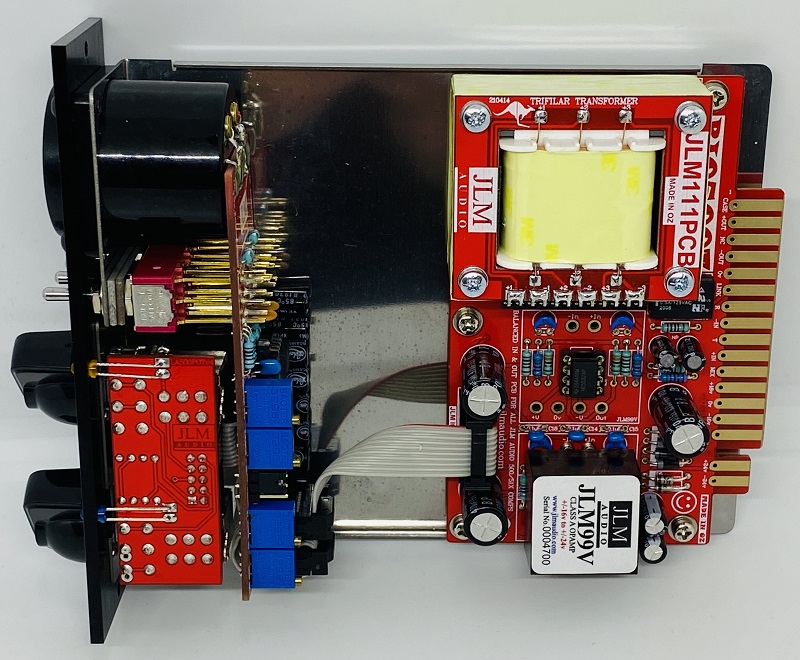

BIO500T PCB kit
1. Fully 51X and 500 compatible. 51X pins shorter so PCB will plug into 500 rack without having to cut them off.
3. PCB automatically uses the highest power available. +/-16v for 500 and +/-24v for 51X.
4. LA500 PCB also has mix buss out on pin 11 for Radial Workhorse racks.
BIO500T PCB.
Fit 6 x 1mm sockets for 99v opamp. Do NOT press the sockets in. Just let them sit in the holes. Use a piece of cardboard to hold them in while turning the PCB over.
If you are not 100% with resistor colour codes use a multimeter to check values as you place the resistors
Fit all resistors at once bending the legs slightly outwards to hold them in place. This helps to make sure no resistors are put in the wrong position.
Solder all resistors while holding PCB firmly upside down on a flat surface.
Cut all resistor legs off at top of the solder joint and double-check no solder joints missed soldering.
Fit the 4 x 1N4007 diodes (& 2 x 3v3 Zener diodes BIO500v2). D1 to D6 Diodes are POLARIZED and must go in with their stripe matching the strip on the PCB overlay. Solder diodes in once you have checked their POLARITY is correct.
Fit and solder Relay & DIP8 socket. Make sure the POLARIZED socket matches the PCB overlay. Bend 2 legs out to hold the relay in place for soldering. Solder relay in place once POLARITY has been checked.
Fit and solder 3 x 0.1uF MONO caps & 4 x 47pF in place. The 100nF & 47pF caps are NOT Polarized so can go in either way around.
Caps 01.uF should be marked 104 or 0.1u or 100n. 47pF should be marked 470 or 47p. Fold 47pF caps down flat to PCB before soldering them.
Fit and solder IDC headers in the POLARITY shown. Do not reverse. The triangle on the header indicates pin 1 which is the square pad on the PCB.
The front opening in the IDC headers should both now be facing as shown below.
Fit and solder 100uF & 10uF Electro caps to PCB.
The 2 x 100uF caps are POLARIZED so must have their long positive leg fitted to + marked on PCB overlay.
The 2 x 10uF caps are NON polar types so can go in either way around on the PCB.
Fit and solder 470uF Electro caps to PCB.
The 3 x 470uF caps are NON polar types so can go in either way around on the PCB.
Fit and solder Gold Pins to PCB.
Some PCB batch have had holes a bit to small, if so click link below to see what to do https://www.jlmaudio.com/forum/viewtopic.php?p=4902#p4902
Fit Transformer to PCB
Fit NE5532A opamp in the correct POLARITY shown. 99v opamp can be fitted now or later. LA500 PCB is ready to go.
Fit BIO500T PCB to Bracket

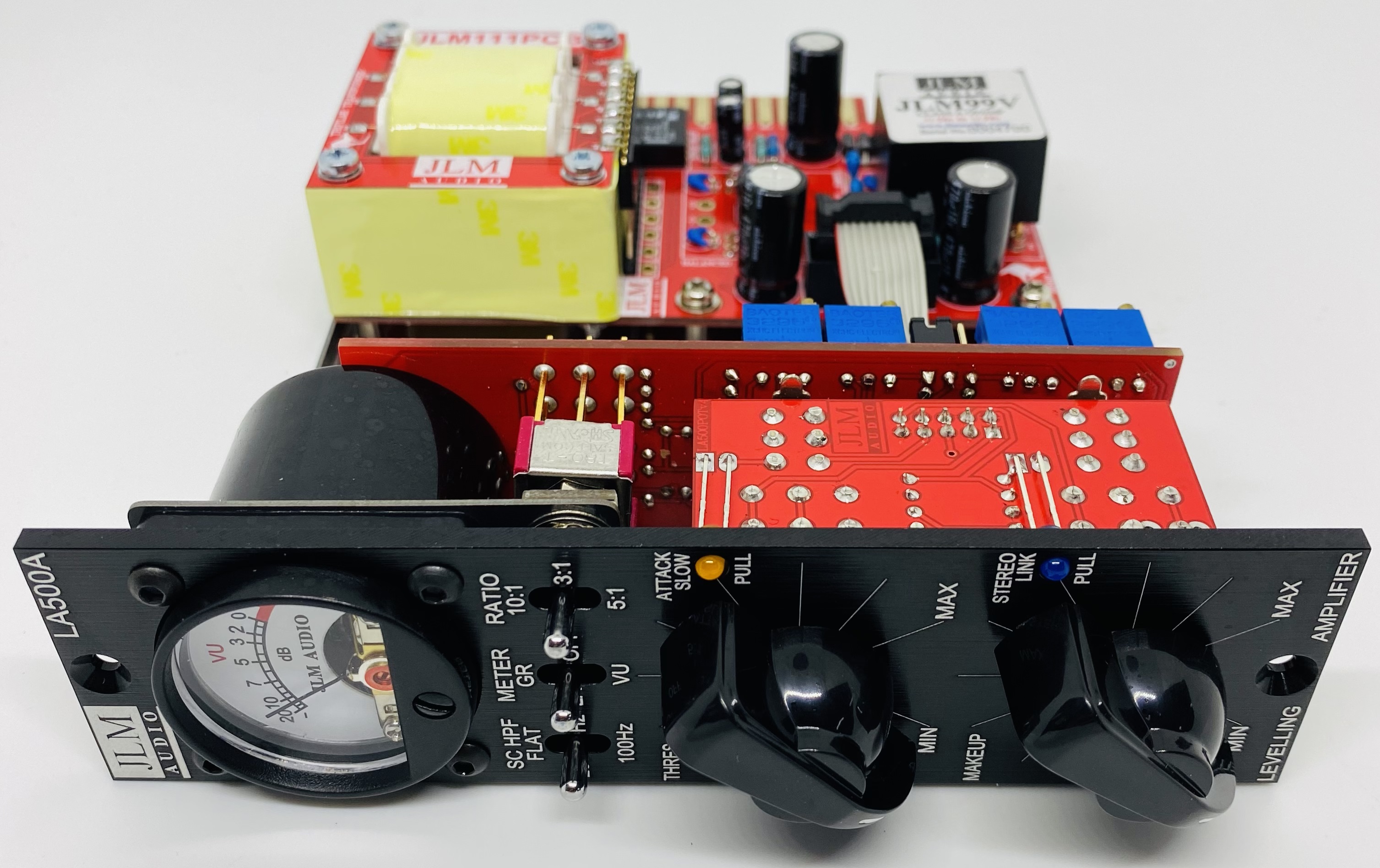

THE LA500SCv3 PCB is the MAC PCB but with no hand wiring and slow attack parts added
NEW LA500SCv3 PCB has some extra holes under U1 & U2 optos which can be used for opto as well
LA500SCv3 schematic at the link below is the same.
http://www.jlmaudio.com/LA500A/LA500SCv3/LA500SCv3%20Schematic.pdf
LA500SCv3 PCB parts kit
LA500SCv3 PCB. PCB overlay has all values and there are no options.

Plugin NE5532AP opamp the correct way around as shown below and put the built LA500SCv3 and the 3 switches leftover back in the plastic bag and move on to the LA500POTv5 kit.
LA500POTv5 PCB holds the Threshold & Makeup pots with their pull switches for slow attack and stereo side chain linking as well as the new leds.
so PCB can be assembled directly from overlay.

Final Assembly of LA500A
SETUP WITH TOGGLE SPACERS
Remove all nuts and washers from toggles. Fit 2 Toggle Spacers.
Fit nuts on each toggle and only do up finger tight.
Place into the Bracket and fit lock washers and nuts
DO NOT USE TOGGLE SPACERS WITH NO REAR NUT AS IT WILL PULL THE TOGGLES APART.
SETUP WITH NO TOGGLE SPACERS
Wind the back nuts fully down onto the 3 switches. Fit the flat washers on next.
Cut the sides of the middle flat washers with side cutters so it does not overlap the other washers.
Fit the 3 shake-proof washers on next.
Fit nuts and hand tighten to check alignment.
The threaded section of the 3 toggles should be level with the meter section of the stainless steel bracket.
Adjust if needed before tightening the 3 nuts.
Fit Meter into the stainless steel bracket from the front.
Fit front panel and fit 2 meter screws hand tight to hold the assembly together.
Fit LA500POTv5 PCB pots into bracket and front panel and do up pot nuts tight to hold the assembly together.
Fit the rest of the meter bolts and tighten all 4 bolts gently. Do NOT over-tighten them or you may strip the bracket thread.
Lock-tight can be useful in an always traveling lunchbox to stop them from shaking loose.
Bend up meter solder tabs so LA500SCv2 PCB can be slide directly onto the switch legs.
Hold down LA500SCv5 PCB flat against the meter so it is sitting parallel to the front panel and solder one leg of the top and bottom switches to hold in place.
Fold meter tabs down hard against the PCB and solder.
If the tabs spring up use a small screwdriver to hold them down while soldering.
Plugin ribbon cable from LA500POTv5 PCB and push any extra length back in between the 2 PCBs
If everything looks parallel and neat you can now solder all toggle switch legs with the LA500A face down.
Solder each row of 3 and cut the excess off so you can get to the next row under it.
Fit the LA500 PCB to the 4 threaded stand offs with 4 x 3mm x 6mm bolts and lock washers.
Fit short ribbon cable between LA500SCv5 and LA500 PCB
Fit LEDs as shown below. The Long LED leg goes to the square solder pad. Do NOT swap the colours as they will not be the correct brightness.
With LED held hard against the front panel grab both legs at the front edge of the PCB holes. Fold both legs at 90 degrees and trim folded part of leg to about 3 to 5mm long.
Solder LED legs to PCB.
Fit JLM99v on the the LA500A PCB
Make sure the pots are turned fully counterclockwise and fit knobs so they line up with the MIN dial line.
