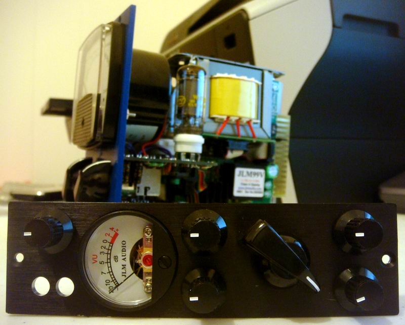

So I'm toying with the idea of putting these Micro Auto Compressors into an API 500 format or in a DBX 900 case. This cuts down on power supply needs. I'm not sure if I could cram it all into a 500 series L Bracket. The meter (if I used the current one) might just barely fit in with 2 mm on either side - depending on how good the tolerances are for the cutouts. With the 500 series I would probably have to figure a way to stack a dINgO as well and fit in a link with another.
The JLM 34mm VU Meter fits fine in 500 modules as we are using them in our up and coming Fet and Opto 500 comps. See prototype CNC front panel below

Joe that's great! With every post that I see you do I get more and more excited about your gear. I know that sounds silly but... What was that in the background... something with a preamp tube in 500 series format!
