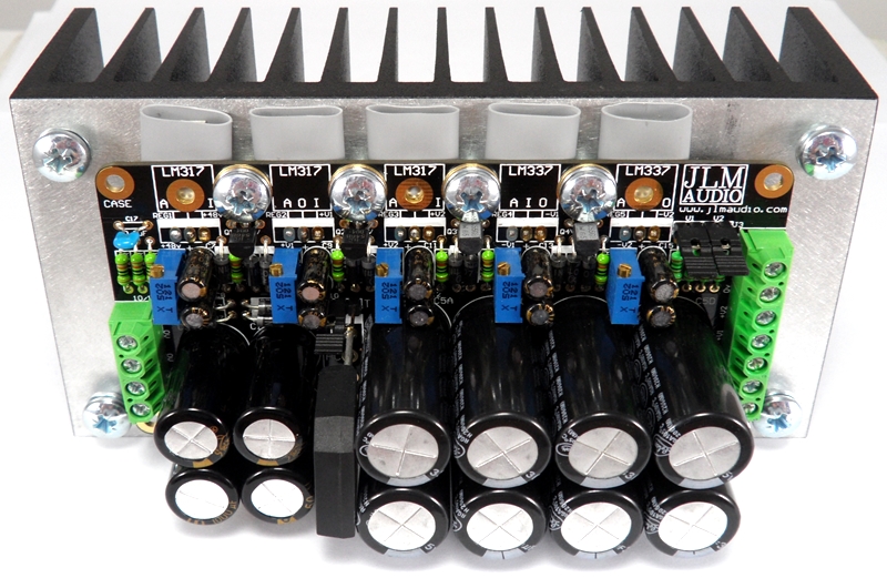

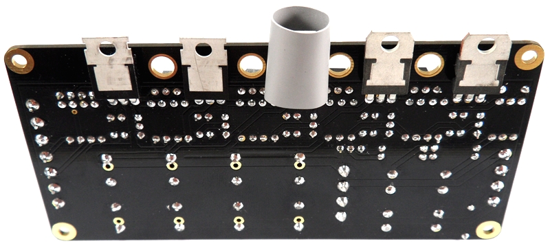

NEW KRAFTWERK 5 rail super power supply kit powers up to 2 x 11 way 500 racks or 2 x 51X racks loaded with 11 x 500 & 11 x 51X Modules. Kraftwerk has tracking and auto shutdown for each +/-V1 & +/-V2 pair of power rails. So +/- rails power up and shutdown together minimizing thumps and pops in any audio equipment it is powering. Also if a fault over currents and shuts down a power rail the other power rail will shut down in sync protecting expensive DOA and DIP8 opamps from internal latch up which can kill opamps. Uses silicon tubes on regs and 4 x 5mm bolts to locate PCB and hold the regs firm to the heatsink. So no white bush and hole burr cutting silicon pad problems. Can be quick released from heatsink in seconds for any maintenance. Fits on back or front or inside 2 rack unit high cases. Kraftwerk kit is PCB + all PCB parts. Heatsink is optional extra.

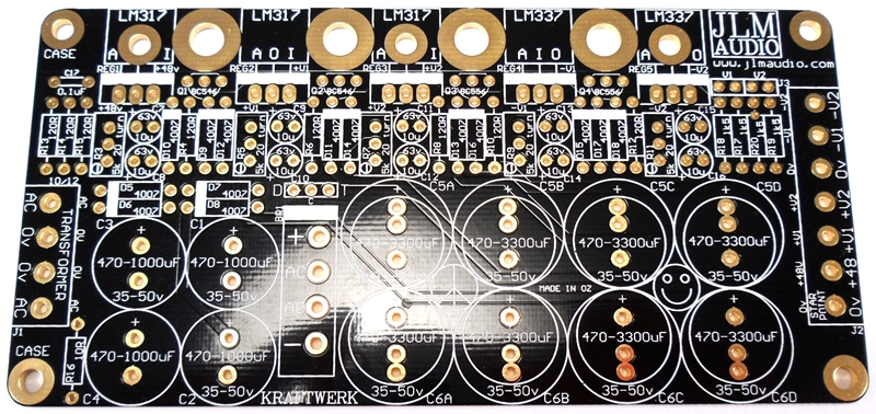

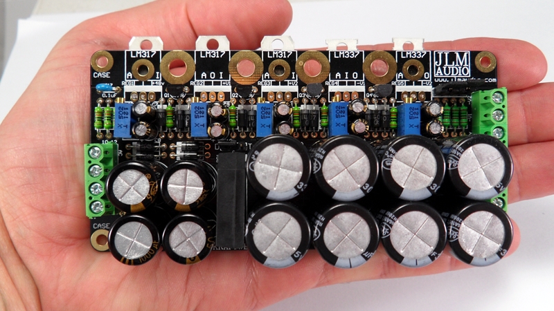

KRAFTWERK PCB is ROHS GOLD HASL PLATED with thick copper. Measuring 121mm (4.76") x 59.5mm (2.34")
Features
5 power rails. (3 positive and 2 negative @ 1.5Amp each)
26400uF (13200uF per +/-rail) Super smoothing cap bank.
+/-V1 & +/-V2 tracking. (eg the +/-V1 & +/-V2 power rails will track each other while powering up or down within +/-0.3v stopping most thumps and pops)
+/-V1 & +/-V2 auto shutdown. (eg if the +16v goes into protect and shuts down it will put down the -16v automatically as well and vica versa)
KRAFTWERK PCB measuring a tiny 121mm (4.76") x 59.5mm (2.34")
Kraftwerk Parts List here
Kraftwerk Schematic here
Build Tips

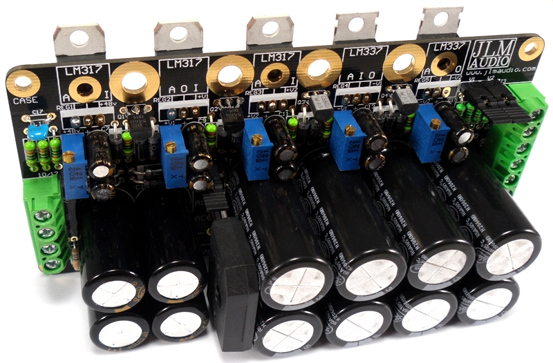

1. Kraftwerk kit builds just like our normal PowerStation kit from lowest height component to highest with the exception of the regulators mounting under the PCB with silicon tube covers.
2. When setting voltages with trimpots on +/-V1 and +/-V2 the 2 computer jumpers V1 & V2 should be fitted to disable the tracking feature. Remove jumpers when finished to activate tracking.

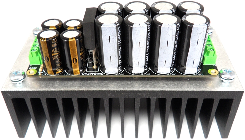

3. Also for most high current work I recommend remote mounting the bridge rectifier away from the PCB on a metal chassis or heatsink as it is by far the hottest component on the PCB.
(If mounting bridge rectifier on the PCB mount it high up leaving as much lead length as possible as this acts as extra heatsinking. Like shown in the photos on this page)
4. If adding the +V1 to +V2 to make 3A power rail set both rails to the same voltage and mix the 2 rails together with 2 x 0.22R 5W resistors. Same works for the 2 negative rails.
5. I recommend as well as correct mains fuse before the primary of the power transformer to also use 2 x 3Amp Slow blow fuses inline with secondary of the power transformer and each AC in.
