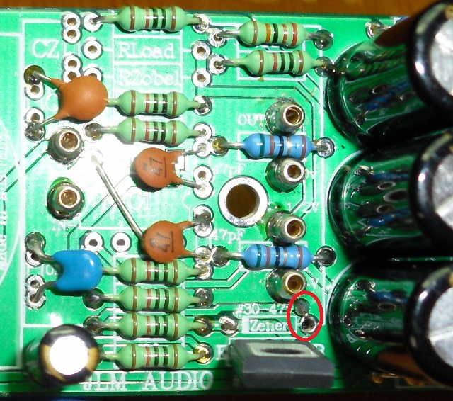

My BA JLM99V with JLM14 is causing the power supply to go into protection mode. I'm using the 48v 25w 520mA SMPS and have applied the soft start mod. One thing I was not sure about was the BD681, the front (of the bd681 the side with the markings) should be facing out from the pcb? Hope the pics explain better than me....
Scott
Re: BA BA2 BA4 BAD Dual99v Build Thread
Posted: Thu May 19, 2011 7:15 pm
by Joe Malone
BeatStudio wrote:My BA JLM99V with JLM14 is causing the power supply to go into protection mode. I'm using the 48v 25w 520mA SMPS and have applied the soft start mod. One thing I was not sure about was the BD681, the front (of the bd681 the side with the markings) should be facing out from the pcb? Hope the pics explain better than me....
Scott
BD681 plastic face outwards is correct.
Is the 48v and 0v wired the correct way around to the BA PCB?
Does the hiccup over current mode happen without the JLM99v fitted?
Do you only have one BA connected to the power supply?
Email me the photo's you have in full size so I can check them over?

The JLM was never fitted and was the only ba on the supply. I am testing this on the bench, would not having the RL and the gain pot fitted be a problem?
The only other thing was at the end of the night I was tired and forgot I turned the temp down on the soldering station and wondered why the solder was not melting
This was on the BD681, could I have overheated and damaged it?
Those are the original size of the pic's. Not sure why they came out so small but I will try to take some more pic's tonight and email them to you.

by Joe Malone
HI Scott
From the big photos you sent there seems to be a solder short between the 2 pads in the red circle below. The plated via hole that has solder in it shouldn't but must have happened when soldering the opamp socket next to it. The via is +48v and the bottom pad of the zener is 0v. This would put a dead short between 48v and 0v. So if you measure between 48v and 0v with a ohmmeter while the power is disconnected you should get 10R meter reading. Remove the solder short and you should be good to go. You do need a Rload before fitting the opamp. And to do the voltage tests shown on the BA overlay. Gain pot doesn't need to be connected for first testing.
