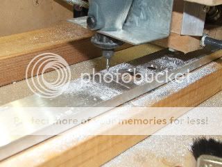

The front panel is to be replaced with a final layout that is to be CNC'd on the new DIY CNC machine. That machine in it's build phase is below.

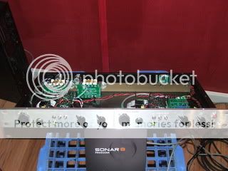

Here's the assembled BA co-habitating with a 1290 in the custom rack. Loads of milling errors but I'm looking into other options over the engraved ones. Too time consuming and the results although good, are not as customizable as some others.... hmm... may consider slide on decals.
Another shot with the lid off.

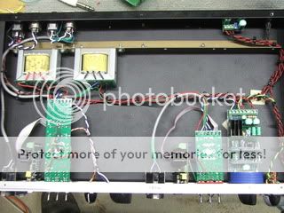

Inside the guts. Not the neatest work but still in 'layout mode' prior to just 'one more panel'.
Here she is getting all milled up.

The controller was going to be a home brew BUT I found some good ones out of rice land that are cheaper, pre built and have more features than anything I could build for the price point. There's a few all over eBay and the one I went for has 4 axis (just in case I get silly), manual controls on board, monster heat sink etc etc... posted to Oz it was $115AUD from memory. Very good value.... so far.
The software is EMC2 under Ubuntu. Basically running an old Athlon 2600 dual boot DAW box and wanted minimal interrupts etc and EMC2 is amazingly excellent given it's 'price'. CAD to G Code is done in CamBam (free release) at this stage. Can't speak highly enough of CamBam for this sort of thing.
About to order some proper/real engraving bits and then have one final go at the engraving (these panels do have some curve to them) and if that isn't great, then I'll be doing up either the Lazertran style label or the adhesive backed laser print to photo paper which can also look pretty good. I can see how I want this unit (finally) and will keep pushing along. It's the old Instrument Tech coming out in me.
